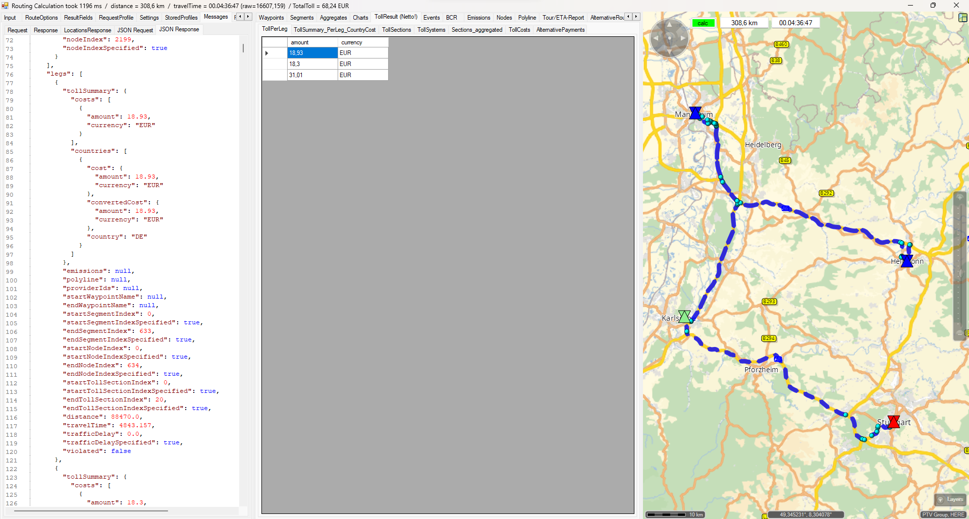

Hello Vytenis,
hopefully the following parameters help you to apply the solution through xRoute2 API:
1. To change vehicle settings in a single routing call look into com.ptvgroup.xserver.xroute.VehicleParametersAtWaypoint This supports OffRoadWaypoint, OnRoadWaypoint and MultiCoordinateOnRoadWaypoint
2. Then you can use the com.ptvgroup.xserver.xroute.Leg property com.ptvgroup.xserver.xroute.TollSummary to get the costs per leg
Is that what you are looking for?
