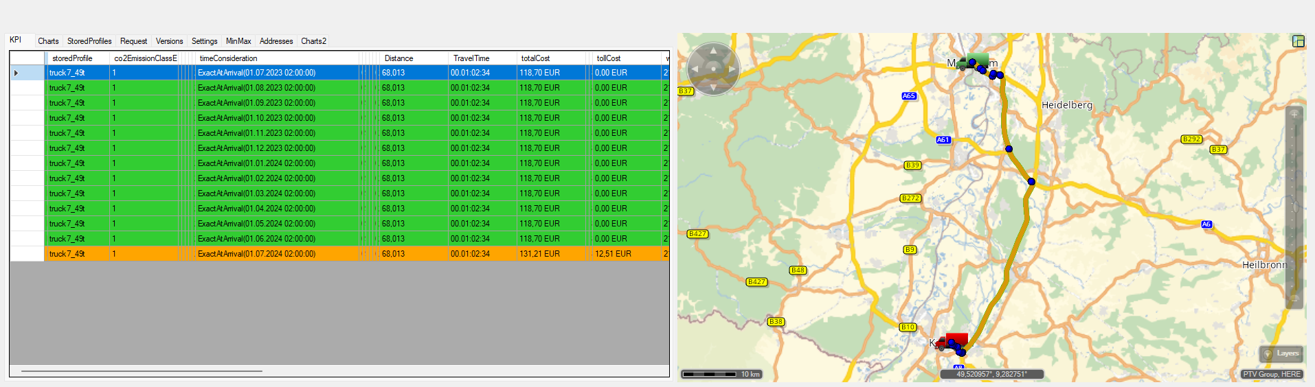

Example for future toll calculation. Based on a monthly reference date the prices change from december 2023 when Germany increases the tariffs for various vehicle categories.
In this example for a 7.5t vehicle you can see the increase of toll for smaller vehicles from 1.7.2024
