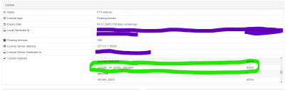

With a proper license you can check this in the admin console: Bernd

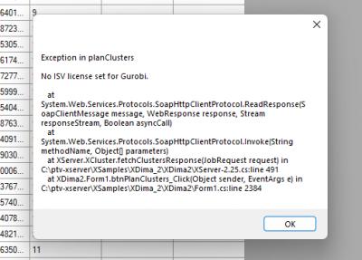

Voila - we updated the license mechanism for the usage of GUROBI within xServer v2.28:No ISV license set for Gurobi.
- Up to v2.27: you were supposed to gather a license file from GUROBI.
- From v2.28: the prorietary PTV license file triggers the usage of GUROBI.
