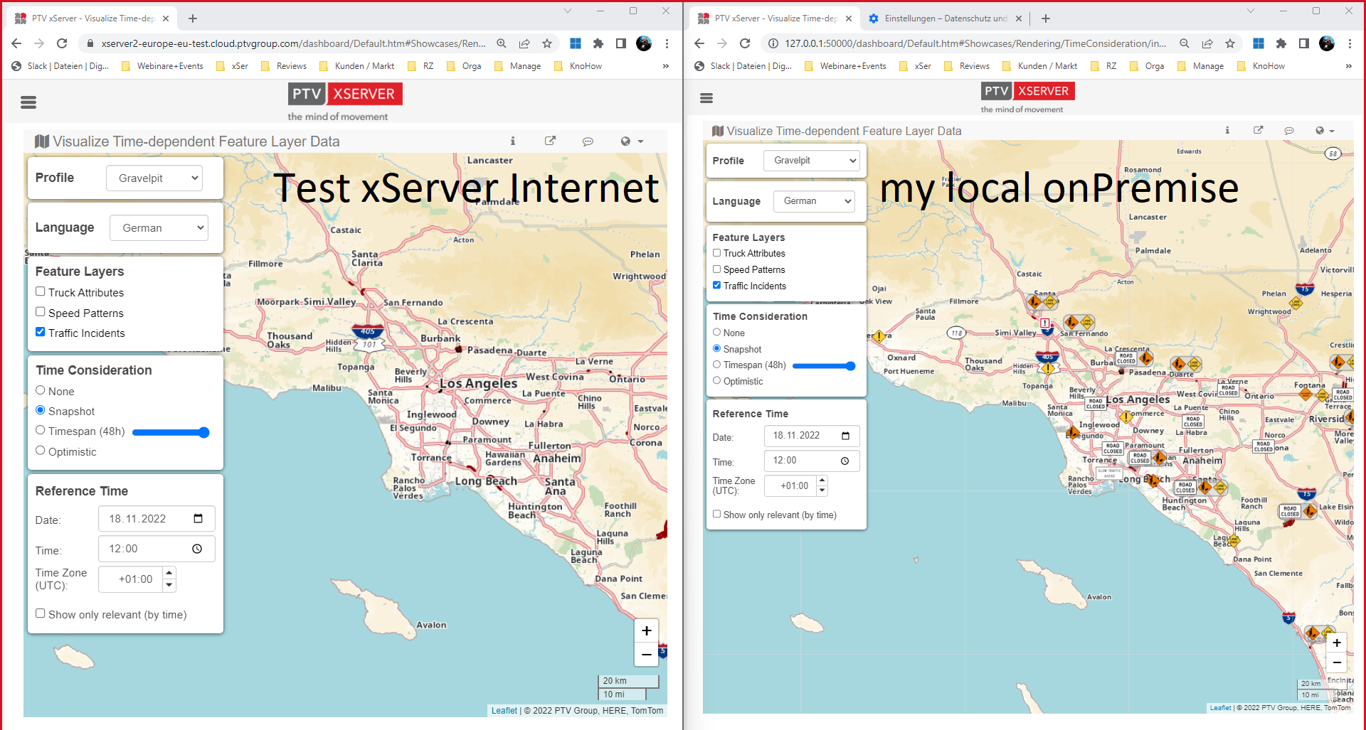

we've been asked whether it is possible to display specific feature layer content even at a very rough zoom scale.
Here's an example of how to do this in an on premise setting:
On the left side we see that the default settings of the fl cause the renderer not to display the icons at the given zoom level.<br />On the right environment the fl data is already displayed in the same level.

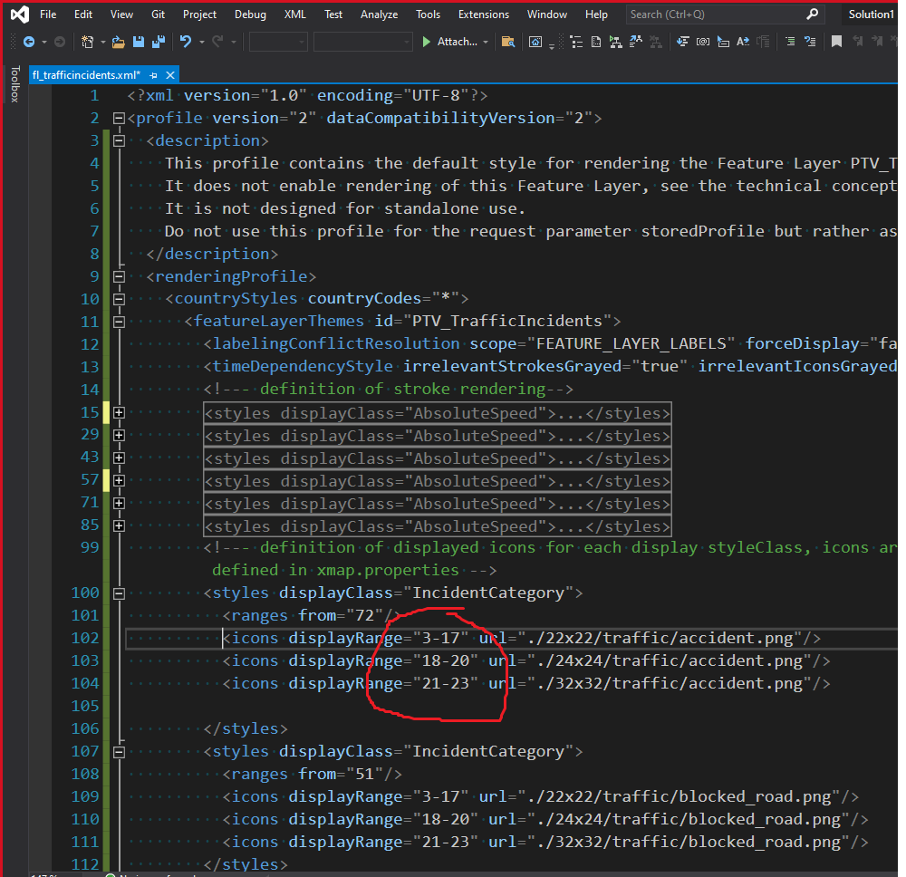

To achieve this change I had to change some files in the "/conf/profiles/rendering":
  • fl_trafficincidents.xml is responsible for the generic definition of the "traffic incidents" rendering scheme.
  • You can find similar files for SpeedPatterns, TruckAttributes, ... in the same folder.
Change the lower bounds of the icon's display range from standard=&quot;8-17&quot; to some value such as &quot;3-17&quot;.
Change the lower bounds of the icon's display range from standard="8-17" to some value such as "3-17".
Furthermore:
  • Repeat this for each icon category you want to show up at a rough level.
  • Ensure to cover the proper geographical sub unit, e.g. "<countryStyles countryCodes="US">" for the United States
  • This updated configuration requires a server restart.
  • After the restart all rendering profiles such as silkysand, gravelpit and so son will use the new definition.
  • Stay patient: the CUS will reload the traffic data - therefore you may have to wait for the reloaded traffic data.
  • On client side you should clear the browser cache to see the changes take effect.
