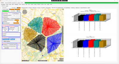

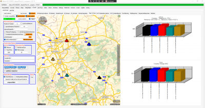

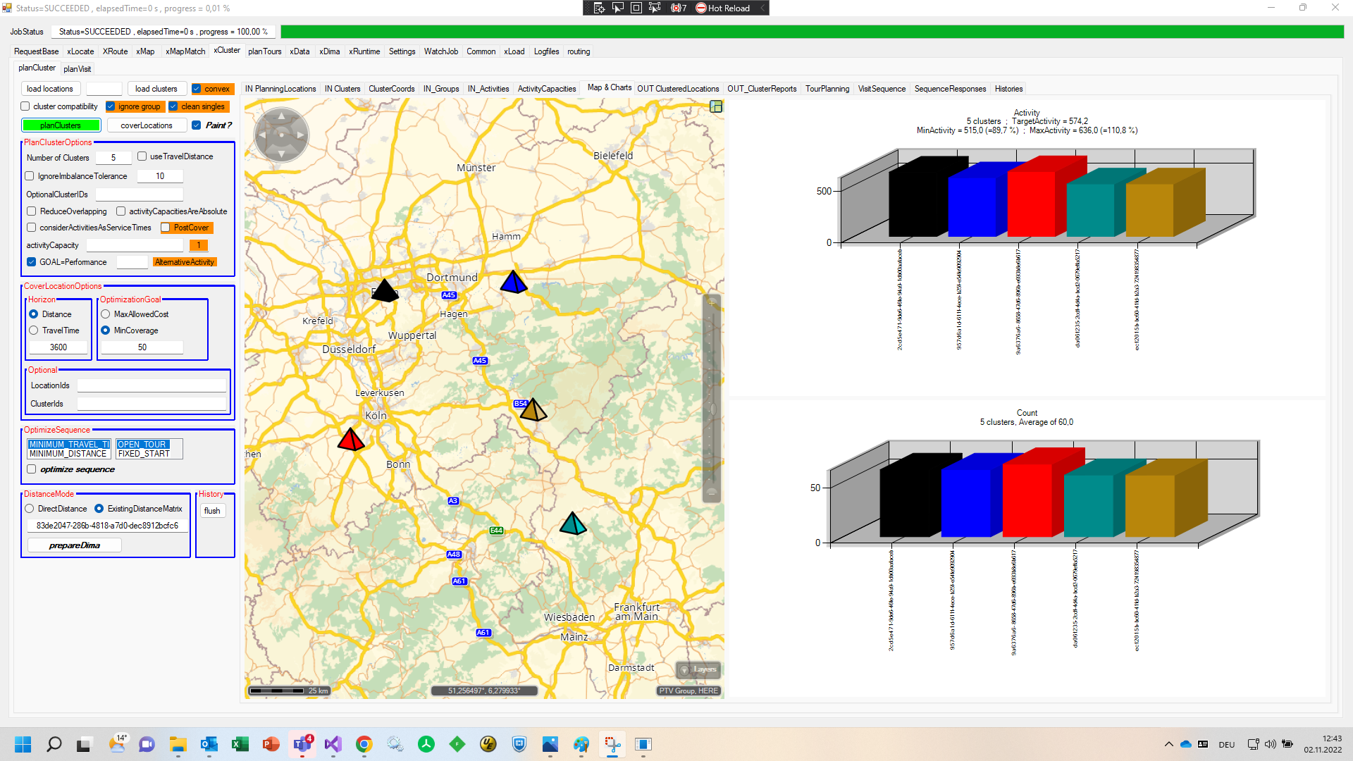

If you apply airline you might get some "rough and obvious" structures but the quality is as good as within a sequencing/tour optimization based on airline: you might be able to identify obvious issues on an airline based model (such as loops and overlaps in a tour). But from a quality perspective only the routed distance matrix based approaches consider geographic aspects such as rivers, valleys, highways (or missing highways).
Comparison of the Distance metric KPIs (xDima2)
the following statement reached me today - a generic topic I'd like to share with you:

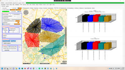

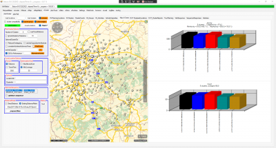

Well, there's a significant difference between the airline and the routing distances. I also created some samples based on same input locations - just the DistanceMode is changed. Both samples have in commonI have a confusion – how beneficial is to use dima in planCluster service? As per my understanding, this service creates territories and just for creating territories how dima is useful? Suppose I don’t want to use estimatedTravelTimeToCluster, then does it make sense to use Dima with planCluster? Because dima is to use calculate driving time and driving distance.
- 300 input locations (heterogeneous activities)
- to be clustered into 5 clusters
- xCluster2.planClusters
