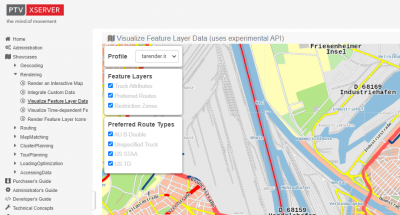

The profiles will be offered in the mapping showcases, too:
- My showcases
And you can gather the description via the xServer2.getServerConfiguration API:
