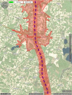

I have question about function to notify if driver drove away 1 km from base path generated from BCR. Does it exist or something with similar action?
Pictures to represent the situation:
Drive on base path from BCR:
Situation, when it should notify:

What is possible with the xServer2: computation of the corridor aka fence!
- 2.5km / 5.0 km fence (default profile)
If you are able to gather a drivers current position while he is supposed to follow a specific track you could create an alert once the GPS position is no longer inside the computed geometry.
I took
com.ptvgroup.xserver.xroute.ReachableAreasRequest.
And here's also
another topic which deals with fencing.
