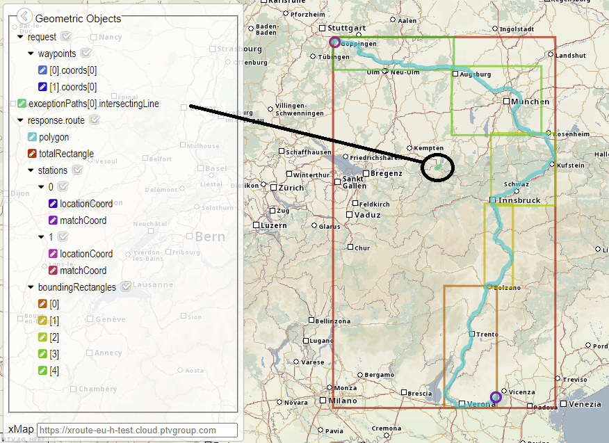

Besides the built in logic of "blocking segments if they match specifc conditions" (such as delivery) you could also consider further ways to block segments in a specific routing, e.g. by using the ExceptionPath object. With this approach you could refer to objects such as specific mountain passes, tunnels and more if they are not accessible through the regular truck attributes. To keep it short: you could describe the exception path via one of the following mechanisms:
  • List of nodes
  • External segment IDs
  • street name
  • binary path description
  • an intersecting line
:!: Attention "intersecting line" and "street name" are the only approaches that do NOT depend on a map version. E.g. if you try to work with BinaryPath you should be aware that this string representation of a calculated route changes with a map update!
Fernpass B179 (D-Füssen : A-Nassereith) blocked via ExceptionPath.IntersectingLine
