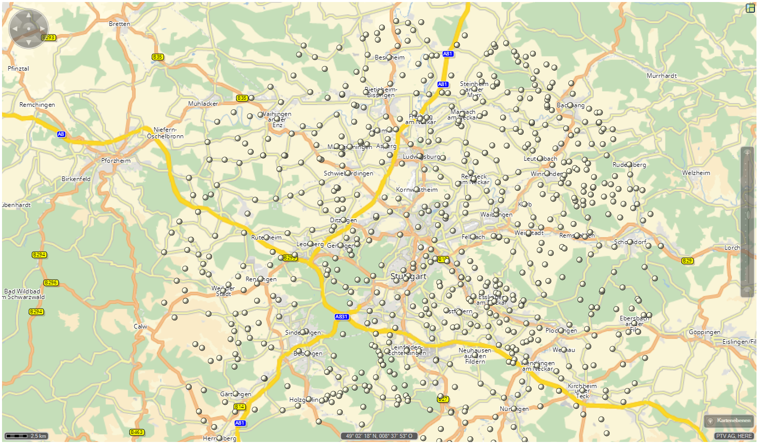

Dummy set of households somewhere in Baden-Wü.

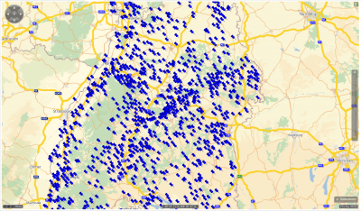

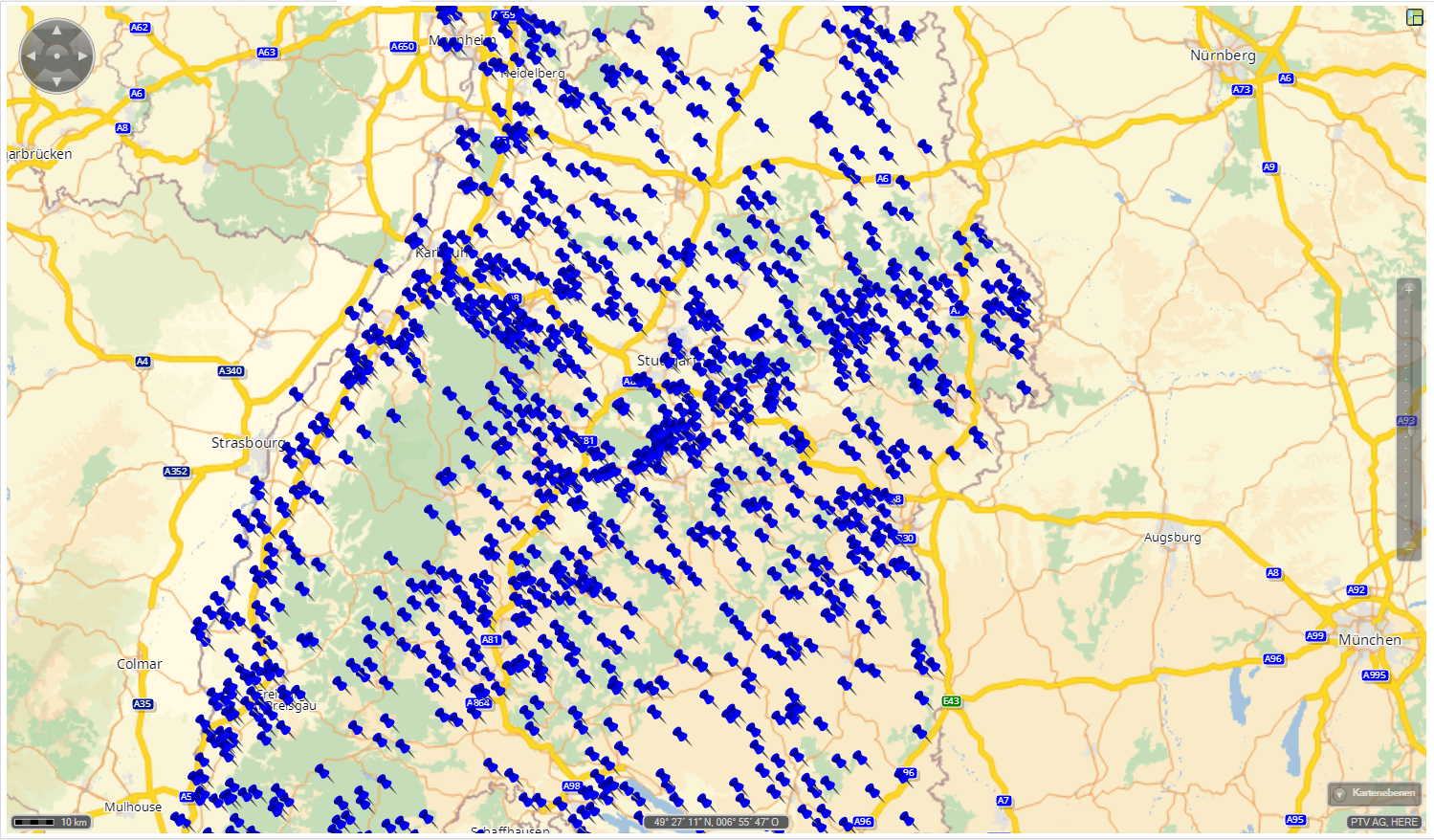

The fire brigades in all Ba-Wü.

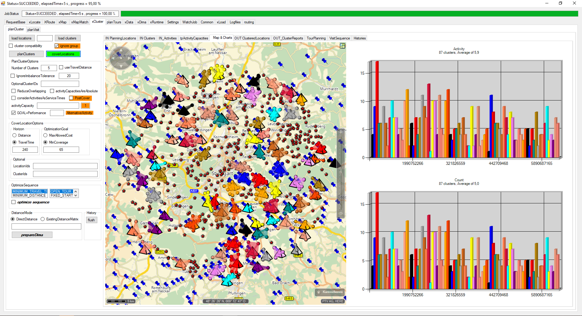

I used xCluster2.coverLocations to check whether it is possible to reach at least 65% of the inhabitants within less than 240secs

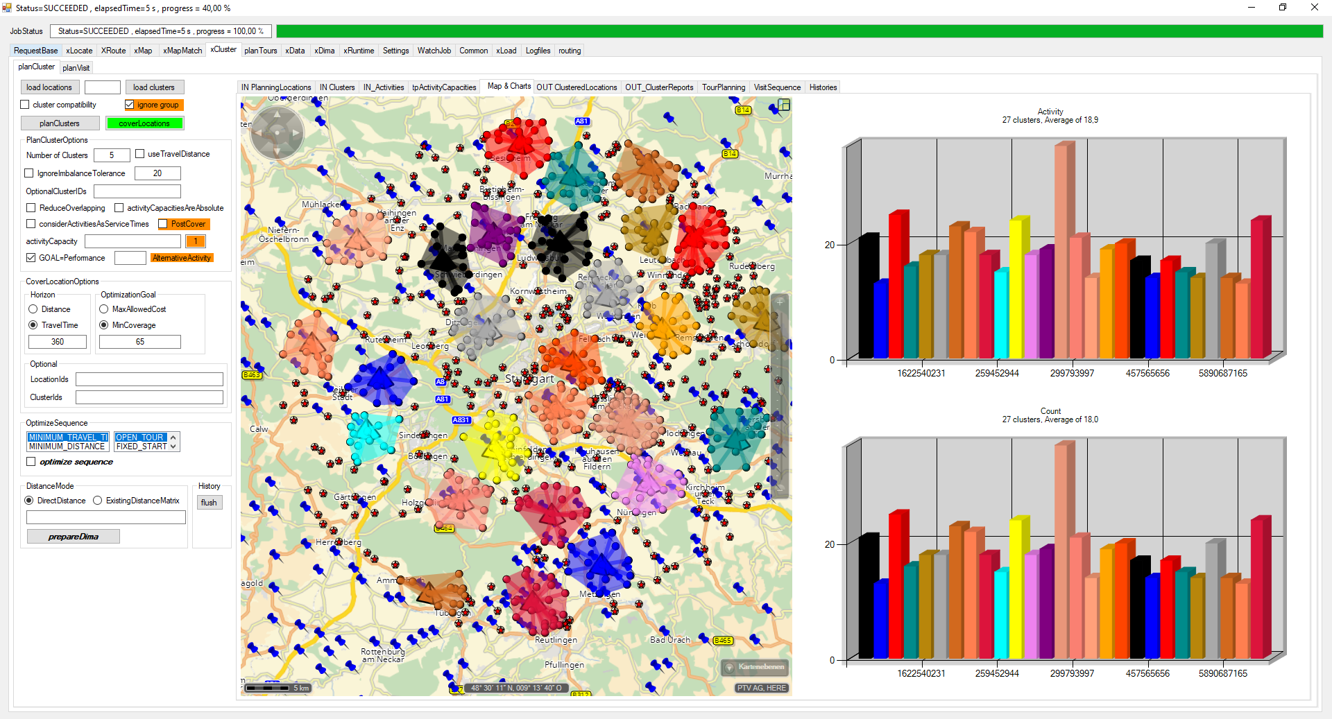

and here's the result with a traveltime of 360 secs
Red starts indicate that the location is outside the required horizon :(
This is just a dummy based on airline - no real data and routing applied.
