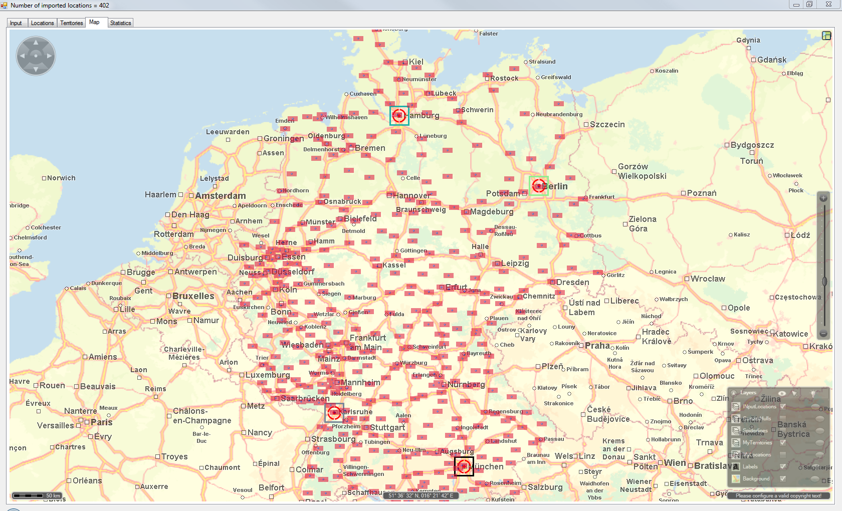

But as images tell more than words just look at the following screenshots starting with the input data
  • Given is a number of 402 customers spread over Germany
  • Furthermore there are 4 existing subsidaries in Hamburg, Berlin, München and Karlsruhe
Input data: the 402 customers and the 4 existing subsidaries

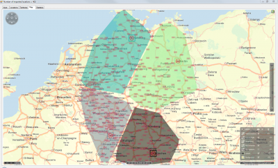

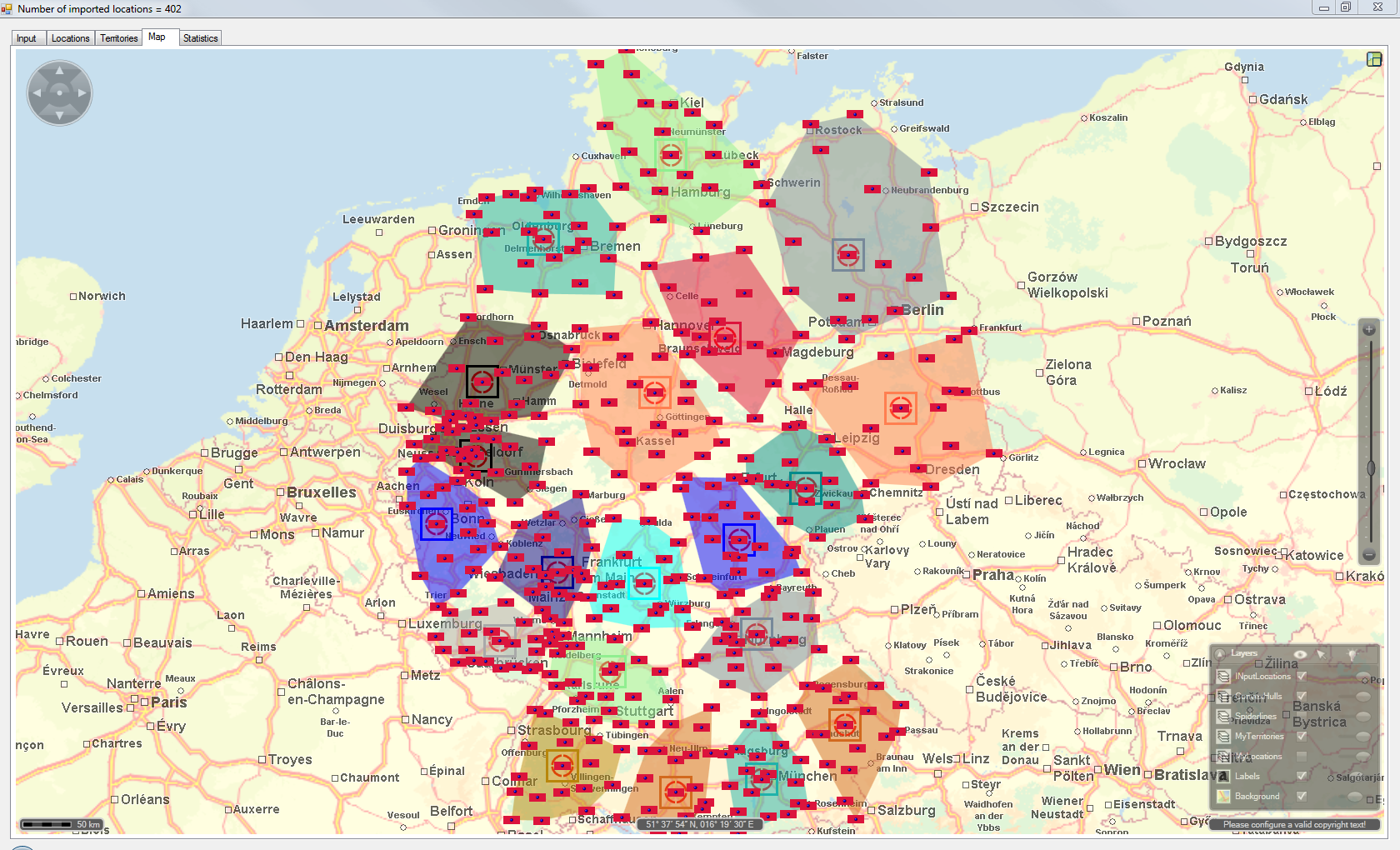

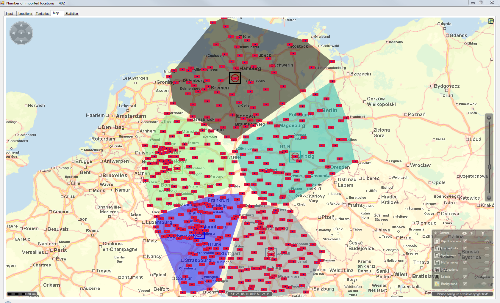

Usecase #1 - planTerritories:
imagine there are no existing subsidaries but you'd like to create some but you are not sure how many you need and where they should be placed. With planTerritories you can simulate and request possible subsidaries
Simulation and creation of 5 subsidaries
Simulation and creation of 20 subsidaries

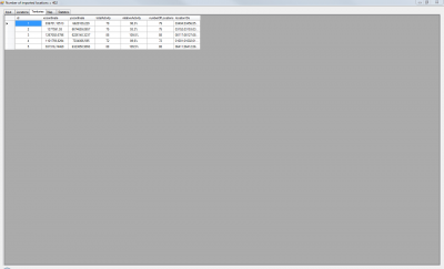

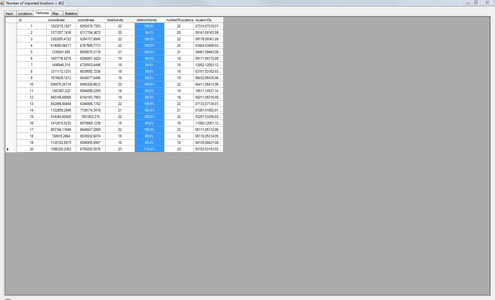

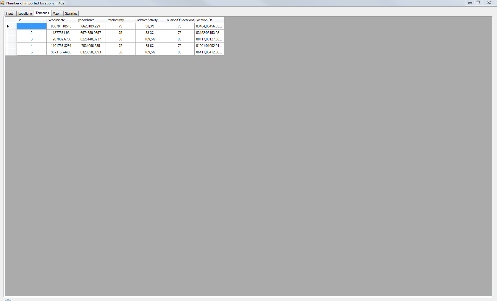

If you compare the statistics of the 5-solution and the 20-solution you can see some key values of a planning result.
Due to my parametrizing in both scenarios the relative range of activity is between 90% and 110%. Enforcing a small range requires more time - more flexible tolerance might produce faster results.
statistics 5
statistics 5
statistics 20
statistics 20

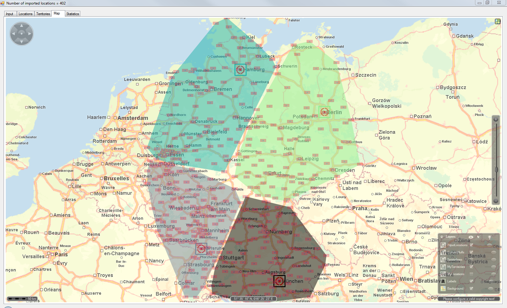

Usecase #2 - distributeLocations :
Now in this usecase we consider the existing territories (four of them) and request to assign the customers to these subsidaries. The number of target territories is therefore the nomber of existing subsidaries. Of course we also enforce the goals continuity, balance and compactness.
Assignment to the existing subsidaries
Existing subsidaries

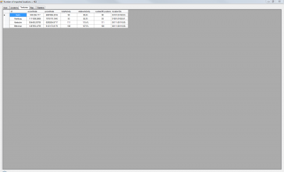

In the statictics you can see that the names of the territories are the given subsidaries in Hamburg, Berlin, Munich and Karlsruhe. The structure of the output is equal to the planTerritories. But in this usecase the centers of the territories are not computed but the subsidaries

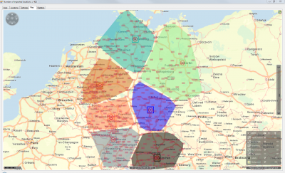

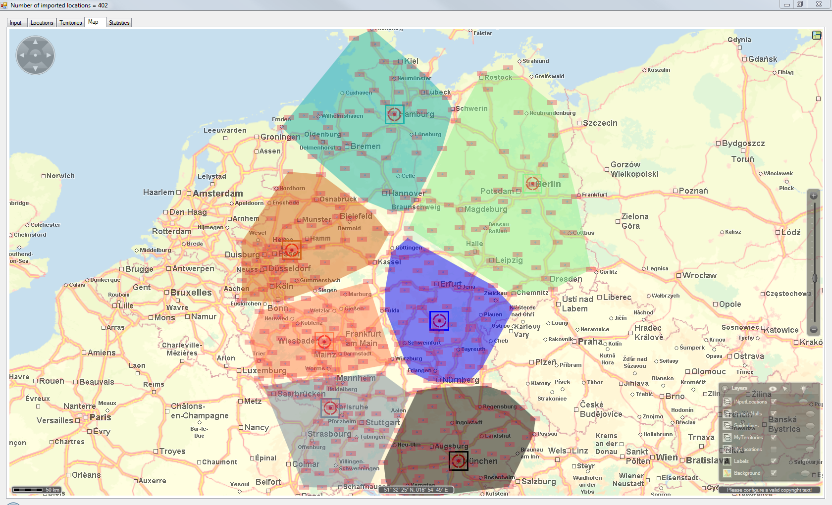

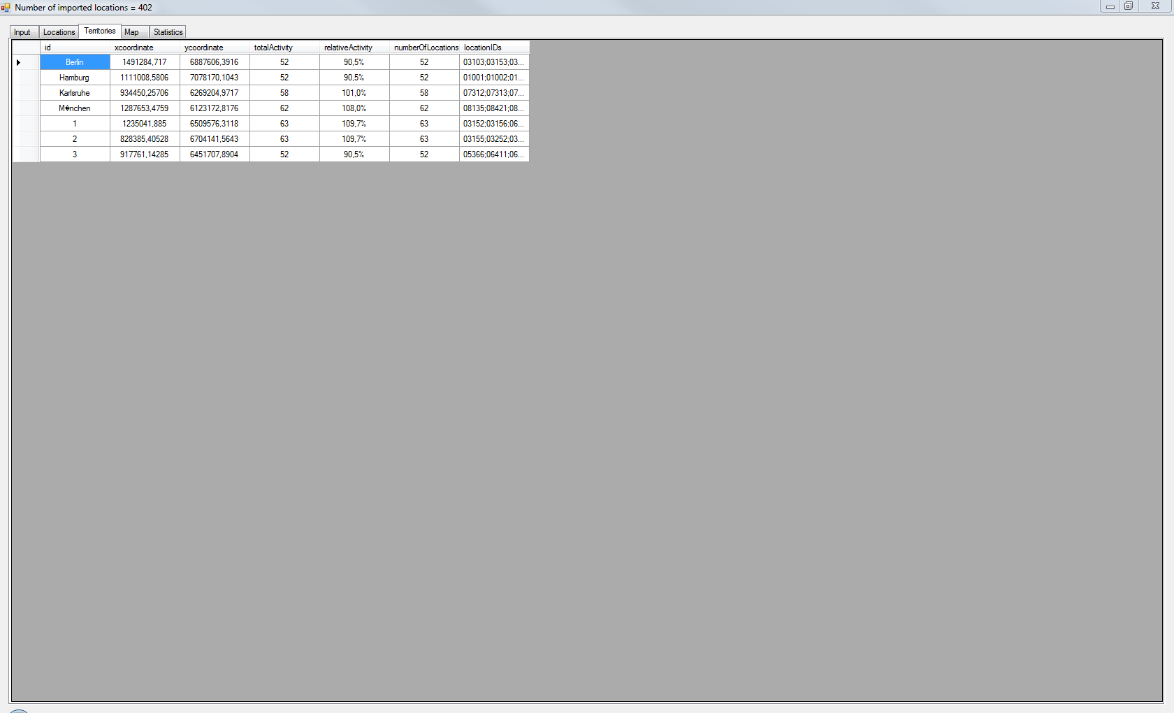

Usecase #3 - changeTerritories:
With this final usecase we merge existing subsidaries with potential new subsidaries. I requested a total number of 7 territories and provided 4 existing subsidaries. This is why the statistics mention the known subsidaries and 3 more proposals.
3 more territory centers in the middle of Germany
mixture between existing subsidaries and 3 more proposals
Tip: the proposed territory centers are always based on the customer locations

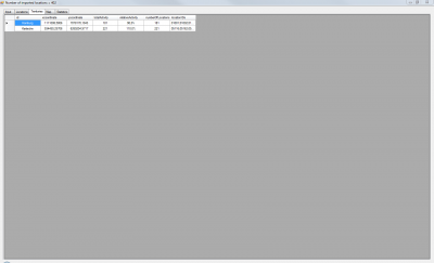

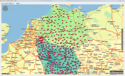

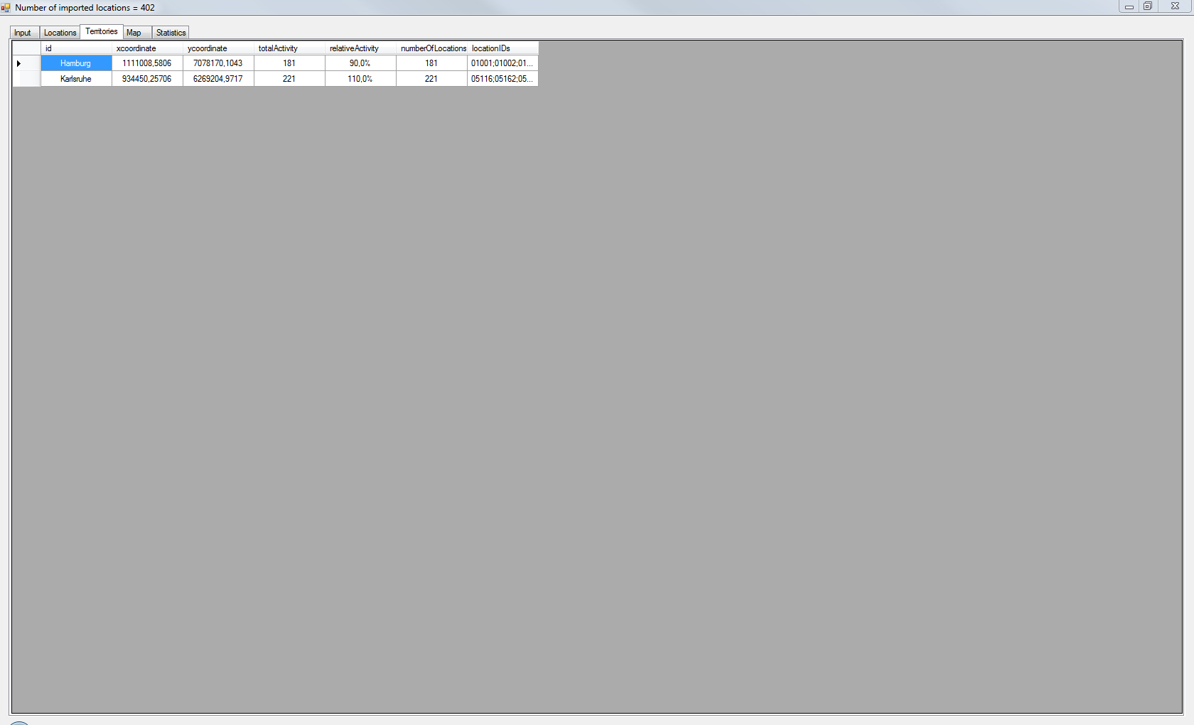

And here is usecase #4:
I have more subsidaries than required and want to know which ones are the best ones to keep.
In the given setting I request 2 subsidaries to be reduced.
This is why one in the north and one in the south are chosen to be kept.
Decisions have been made

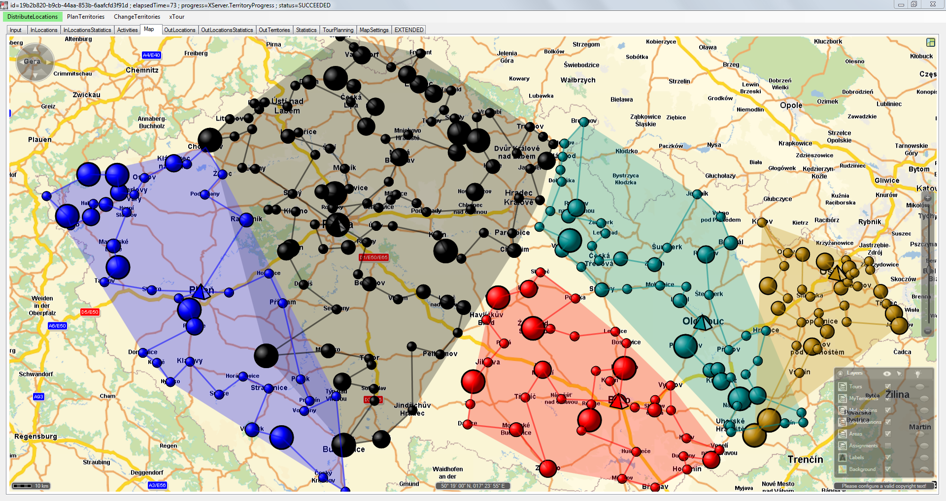

Another little screenshot
  • 5 territories
  • various locations with individual activities (small ball=small activity, large ball=large activity)
  • requested scale between territories 40% : 20% : 20% : 10% : 10% (which is based on number of resources 4:2:2:1:1)
  • result: activities are scaled, number of customers per territory are not scaled
  • step 2: within each territory the number of tours is based on the number of resources, tours are balanced
Feedback welcome!
