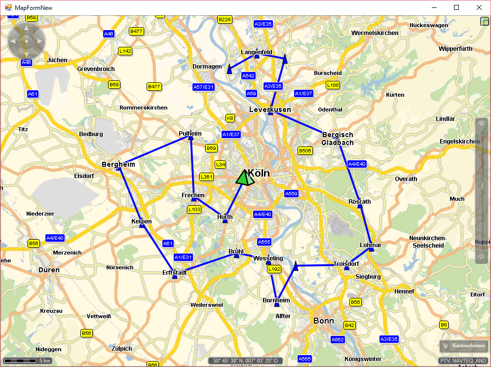

  • Round trips - start and end of a tour is at the same depot (startDepotID==endDepotID, startDepotID>0). Driver gets back to the depot at the end of a tour.
    roundtrip tour
    roundtrip tour

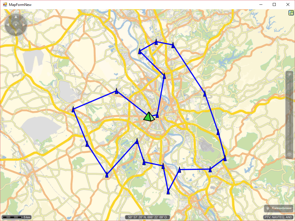

  • Open end trips - either tour starts at depot but ends at customer (startDepotID>0 and endDepotID==-1). Usually meaningful if the driver doesn't get paid for the final section from last customer back to the depot.
    open end
    open end

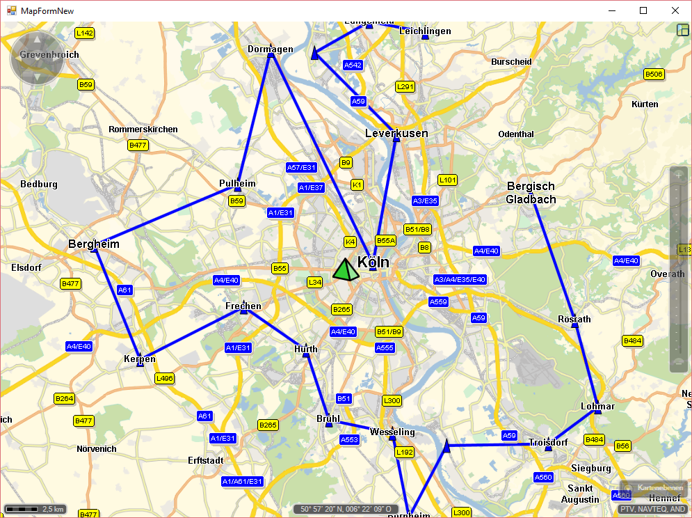

  • Open start trips - either tour starts at a customer but ends at the depot (startDepotID==-1 and endDepotID>0). Usually meaningful if the driver doesn't get paid for the initial section from depot to first customer.
    open end
    open end
