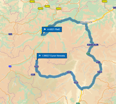

I have another question today regarding xServer2 and routing. A customer has brought to our attention that transit traffic in Austria on the B 180 is closed for trucks over 7.5t, but can be used for origin and destination traffic if there are loading or unloading stations in the surrounding area:
Official documents: https://www.tirol.gv.at/landeck/reschen ... itverkehr/
However, our routing with xServer 2 using the truck attributes always returns a wide bypass route, even though loading and unloading stations are located in the mentioned grey origin/destination areas:
How can we ensure that the correct routing is applied to the B 180 in this case? We appreciate any help you can give us. Here is our routing request:

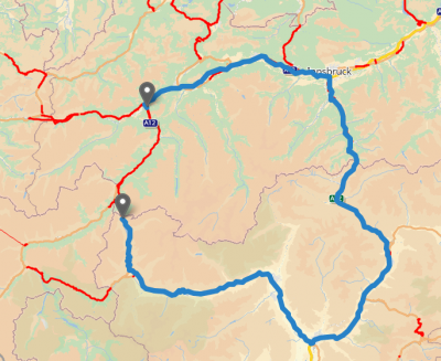

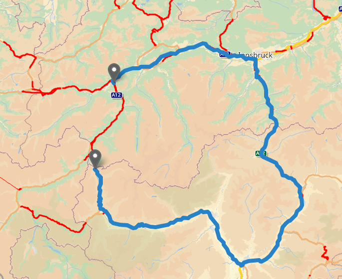

here's an outlook to the upcoming v2.27 feature ;-) Let's start with the old behaviour:
This is before the new implementation to handle QZ: route B180 is avoided

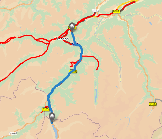

Now the next picture uses the new feature:
The second one is the current result we have with the new feature: truck is allowed to pass through route B180 (internal snapshot)

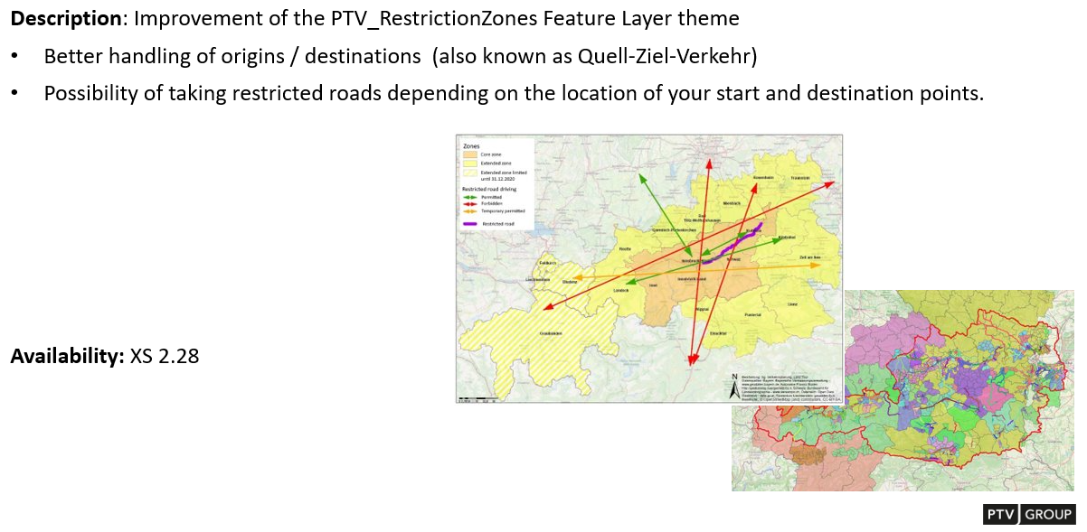

Quick update... the feature with the transit handling will be available in the upcoming v2.28 of the xservers.
I expect this update in the early February 2023.
