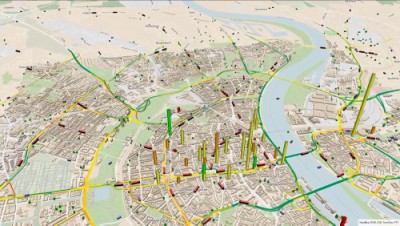

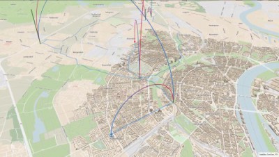

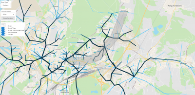

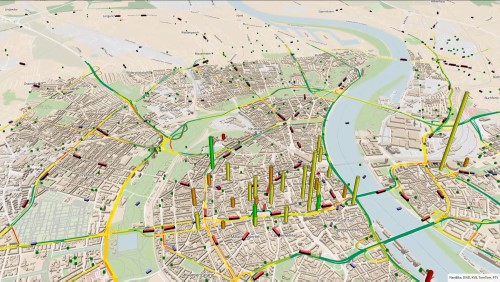

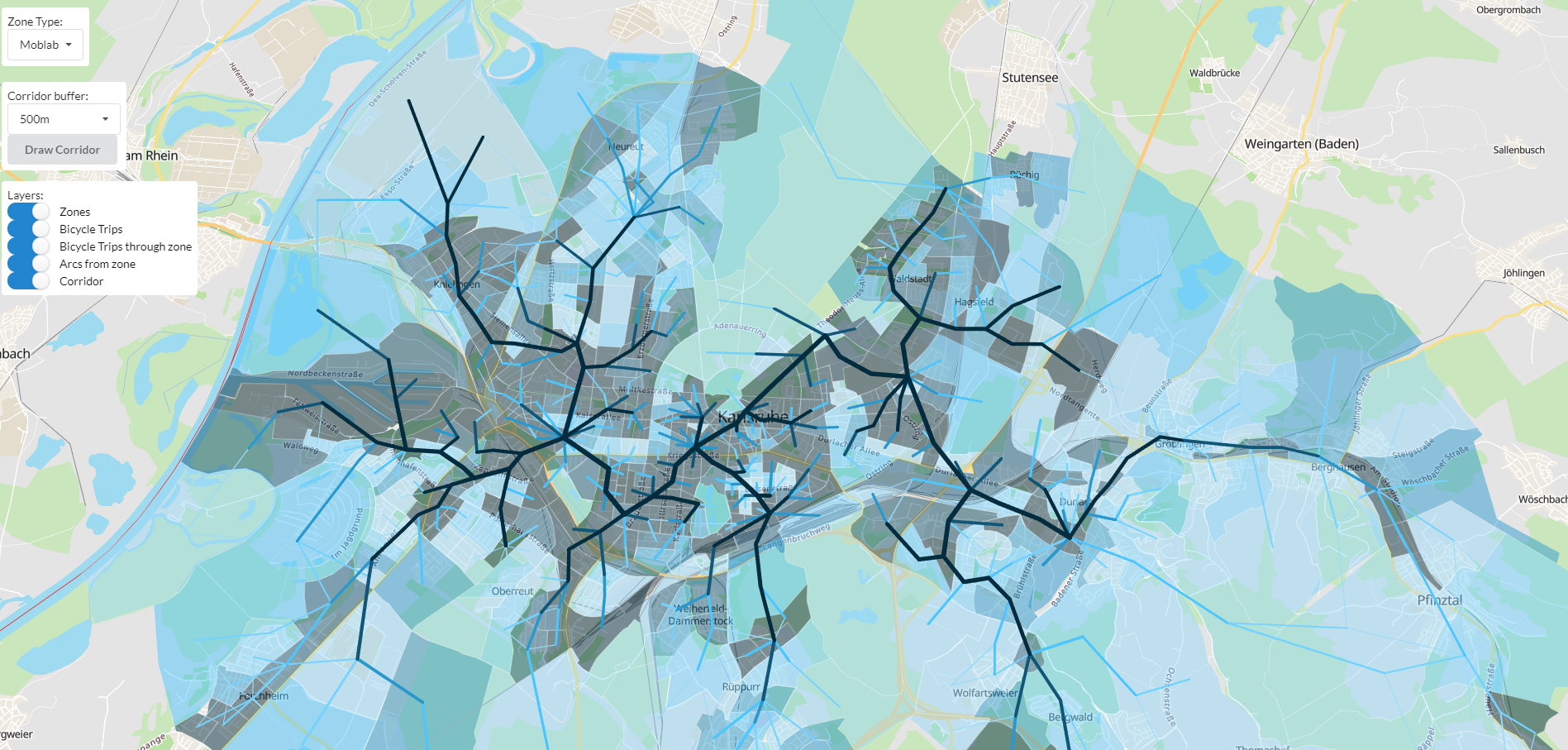

PS: Here are some examples I found on our own pages (list will be extended). Maybe we should set up a gallery
And by the way: the tilted / rotated background maps are provided by the brand new PTV Vector Maps!
