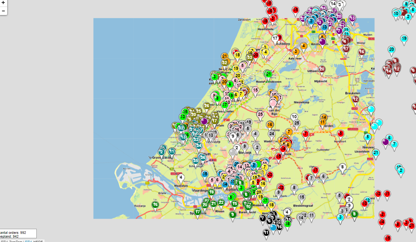

All is working is fine but we notice that when are zooming out in the map, we see a lot of gray parts.
We are using xServer version 1.32 on premise.

What can I do to increase the performance of the rendering? So less gray parts are shown.
