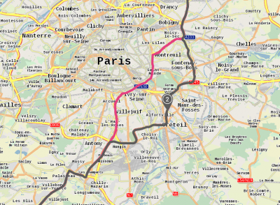

Please find an example below. Currently our profile is set in France in a way that most of the routing is as preferred. However, in this case the routing would choose the inner ring (pink) around Paris, although the preferred routing would be an outer ring (gray), since this bypass is usually has less traffic, especially during the day. However if we change the profile that would use the outer ring, road preferences in other part of France are affected negatively.

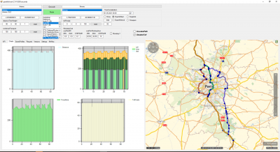

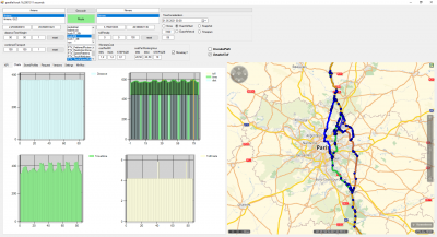

Here is a sample of 85 routings starting at <br />SAT 00:00, SAT 02:00, SAT ... FRI 20:00, FRI 22:00<br />You can see the different geometries depending on the time of the day (check the charts)...<br />(From F-Amiens to F-Nevers)
