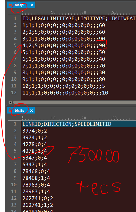

  • We provide speed limits based on pairs of files per IU (=integration unit, usually a country):
    • *.spl : this file contains the structure definition of set of "limit scenarios". Usually somewhere between 10 and 50 scenarios within a single IU
    • *.l2s : this file contains a very detailed list of all the segments in the IU plus a reference to the scenario ID that applies to such a segment.
  • These pairs are provided per IU
  • As segment IDs are not stable between map versions the side tables have to be updated whenever you update the underlying map.

  • Sample for Belarus
    Sample pair from Belarus... 11 different scenarios for that integration unit. Maximum speed on segment 4278 is 90km/h. About 750'000 records in this L2S file fro Belarus (divide it by 2 to get the number of segments)
