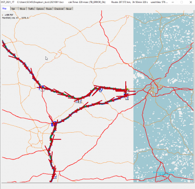

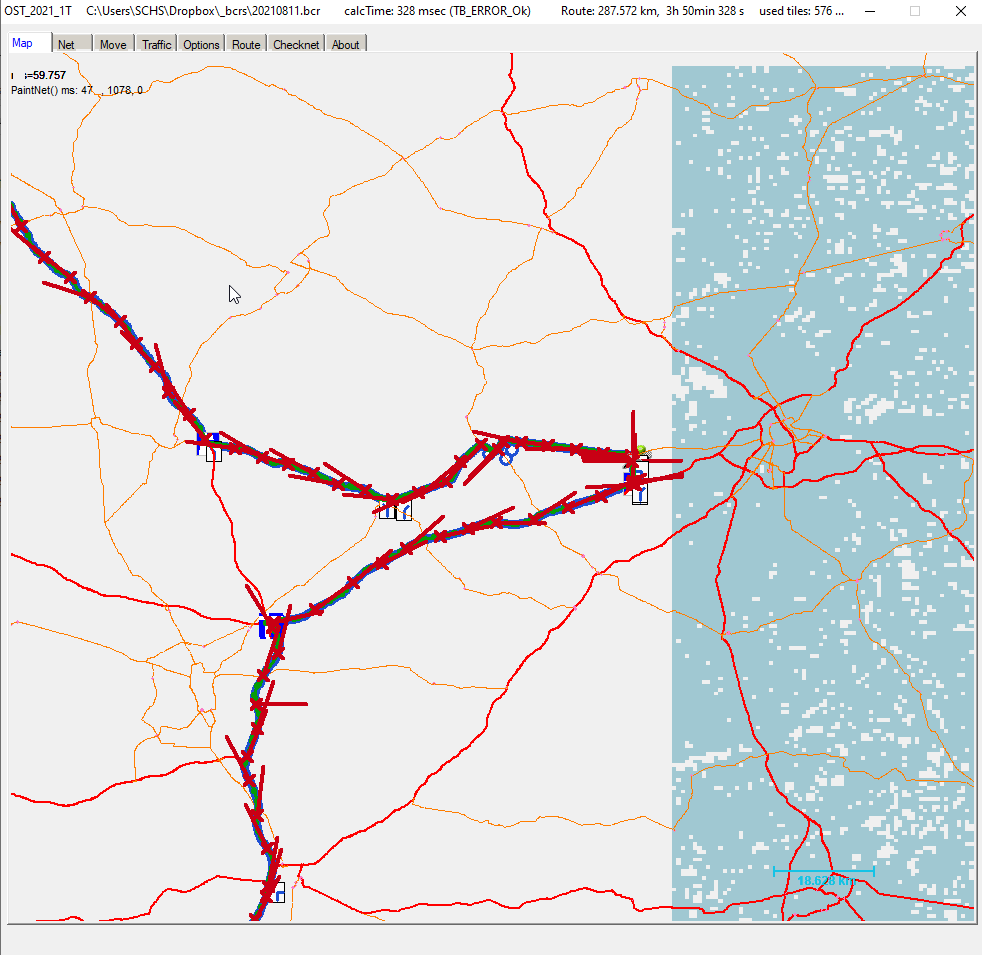

I've attached a screenshot. There you will see that the MVPs are on the exact position as the SDK is calculating the route. So the error lies within the creation process of the BCR with Guided Navigation.

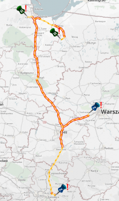

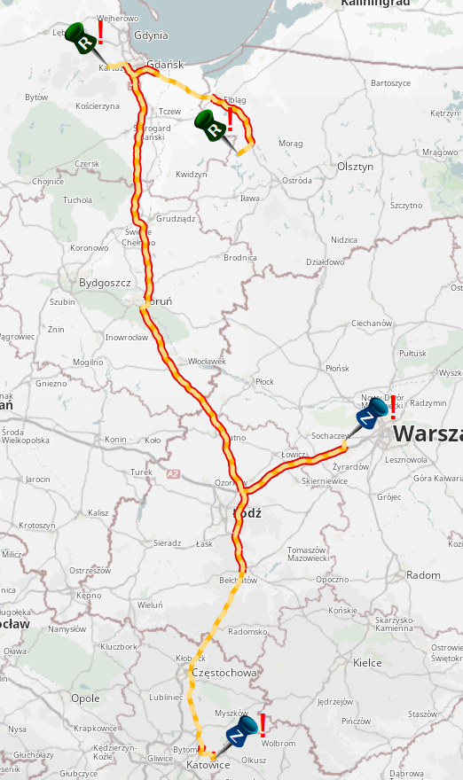

the two different geometries have been caused by some mistake. The pictures / geometries are based on
- shortest route
- fastest route
