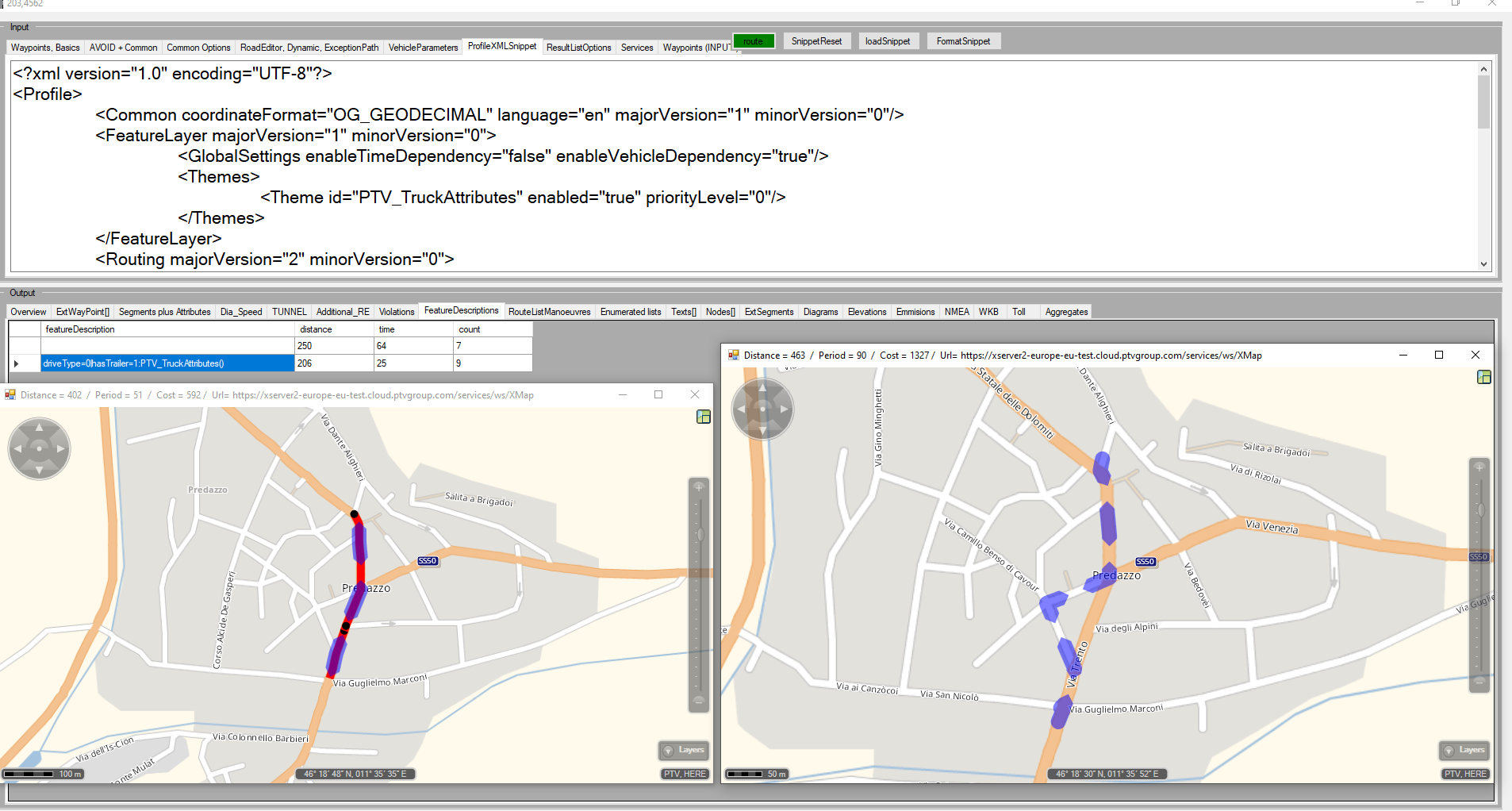

I've been asked how to enforce a vehicle to performa a detour around streets with the feature "driveType=0|hasTrailer=1:PTV_TruckAttributes()" which means "forbidden for trucks with a trailer".
Here's a snippet that demonstrates what you have to do:
  • Activate TruckAttributes (line 7)
  • Tell the engine that you weant to consider AdditionalData and Vehicle specific segment info (line 20,21)
  • Tell the engine how much you dislike the segments which are forbidden for trailers (line24)
  • Tell the engine your trailer weighs more than 0 ;-) (line30)
