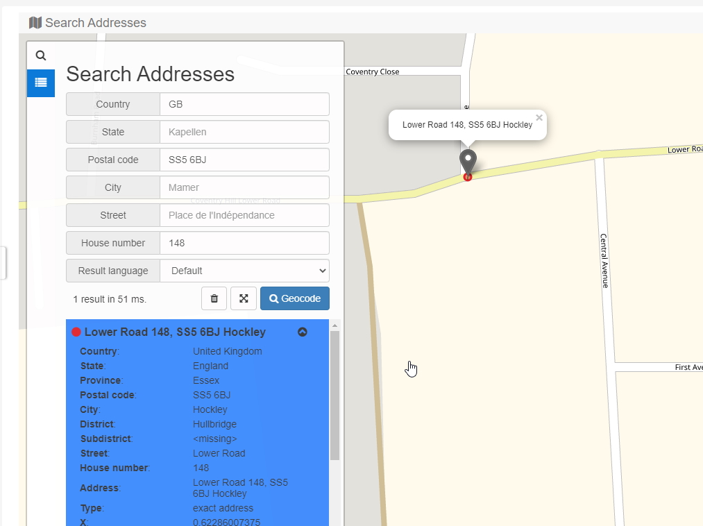

This is not something we can do with xLocate 1 due to the data structures it is using. However we do have xLocate 2. xLocate 2 uses a different data structure from out map provider witch does support full postal codes natively. You can have a look at our showcase to get an idea of the xLocate 2 results: https://xserver2-eu-test.cloud.ptvgroup ... g%7C_____1 .
Screenshot of your example in the showcase:

Conceptually i would disagree. The postal code data of xLocate 1 can only go to postal code detail, while xLocate 2 can go to house number detail and still maintain full postal code.
