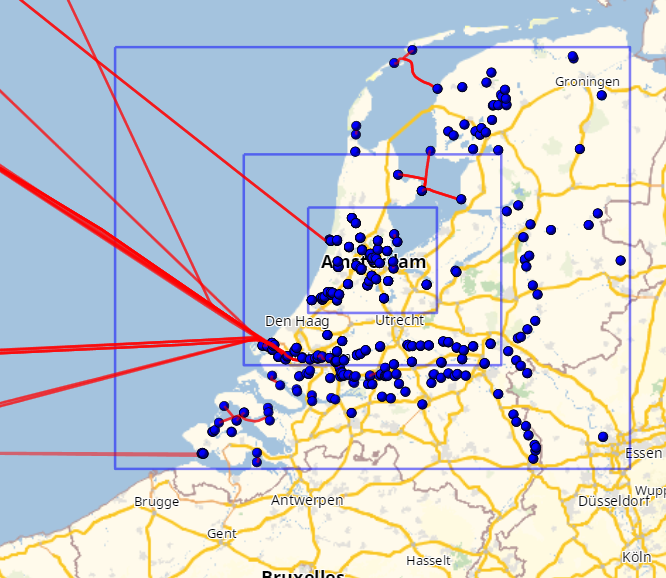

for Amsterdam I took delta_x=0.5 degrees and delta_y=0.25 degrees (and 1.0/0.5 and 2.0/1.0)

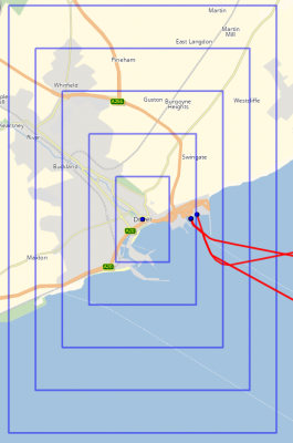

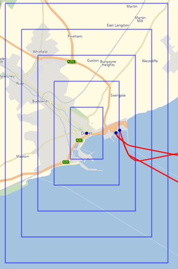

Dover / UK
Dover / UK

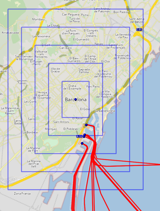

Barcelona / Spain
Barcelona / Spain
