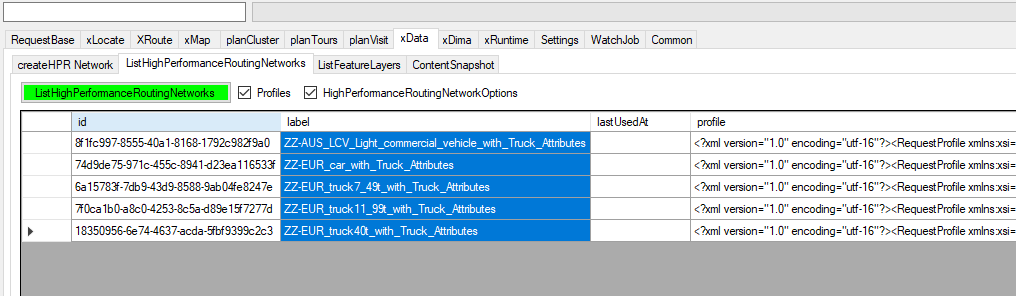

As you may know we offer several so-called (standard) search graphs in the cloud. Their purpose is to speed up distance matrix calculation which is mainly required for
- sequence optimization
- tour optimization
Each search graph is linked to a specific routing profile and as the creation of a Distance Matrix can easily be triggered by using the ID of a graph this is a comfortable approach.
But the ID of a graph may change (e.g. because of a map update). So if you want to stabilize your application you need to ask for the latest ID of the graph that you want to use. For this you need to use the stable element LABEL.
Current LABELs and IDs in the production as of 13.11.2020 (v2.20) : https://xserver2-europe-eu.cloud.ptvgroup.com/<br />Attention: IDs may change - LABEL's are stable
Use xData.listHighPerformanceRoutingNetworks( ..LABEL.. ) to get the proper ID.
Then use this ID in the succeeding xDima.createDistanceMatrix call.
