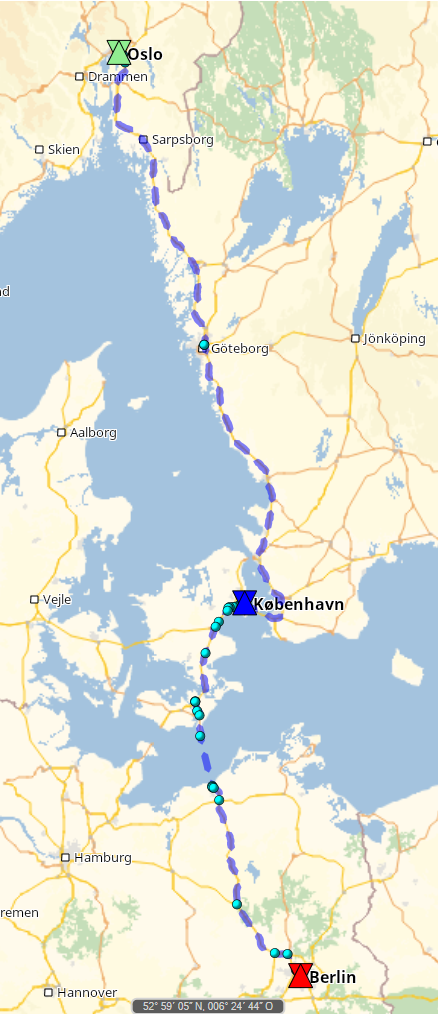

Sample route from OSLO / Norway via COPENHAGEN/Denmark to BERLIN/Germany. Three waypoints, therefore two legs.

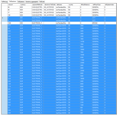

detailed toll sections: national currencies  -  not all countries contribute with an official distance by the way

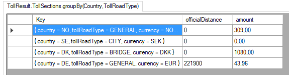

client logic: toll sections aggregated  -  not all countries contribute with an official distance by the way

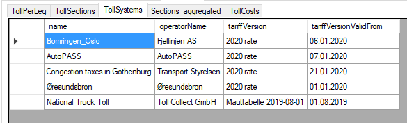

Just to be complete: the systems that are used...
