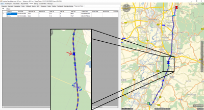

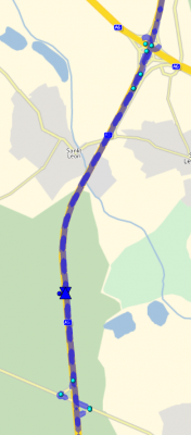

quite difficult to give a precise answer if I just have some few generic statements. Anyhow, maybe I found the cause for this. How about "GPS coordinate drift"?
- Imagine the route SOUTH to NORTH is the original one: travel time is 1:07 for a distance of 69.9km
- Now while the truck is driving from SOUTH to NORTH you gather coordinates. Most times on the highway or east of it
- In my example the coordinate is drifted to the WEST
- The route SOUTH-WEST-NORTH is 84.6km with a travel time of 1:20. At a first glance in the global map it looks like the route is the same as SOUTH-NORTH.
- If you zoom close you see that SOUTH-WEST needs to return towards SOUTH to reach WEST. Furthermore the part from WEST to NORTH starts heading towards the south.

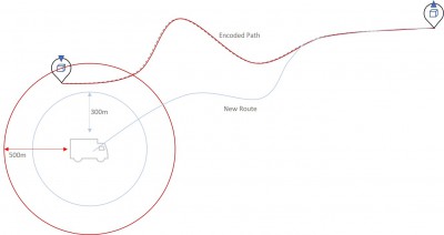

please take a look at this approach: With xRoute2 we provide access to an ETA calculation based on an initial route and the current vechicle position.
In short terms:
- compute the initial route and request it as EncodedPath
- whenever you get a position update send the path and the new position
- you get a EtaCalculationReport in the response
In short terms:
