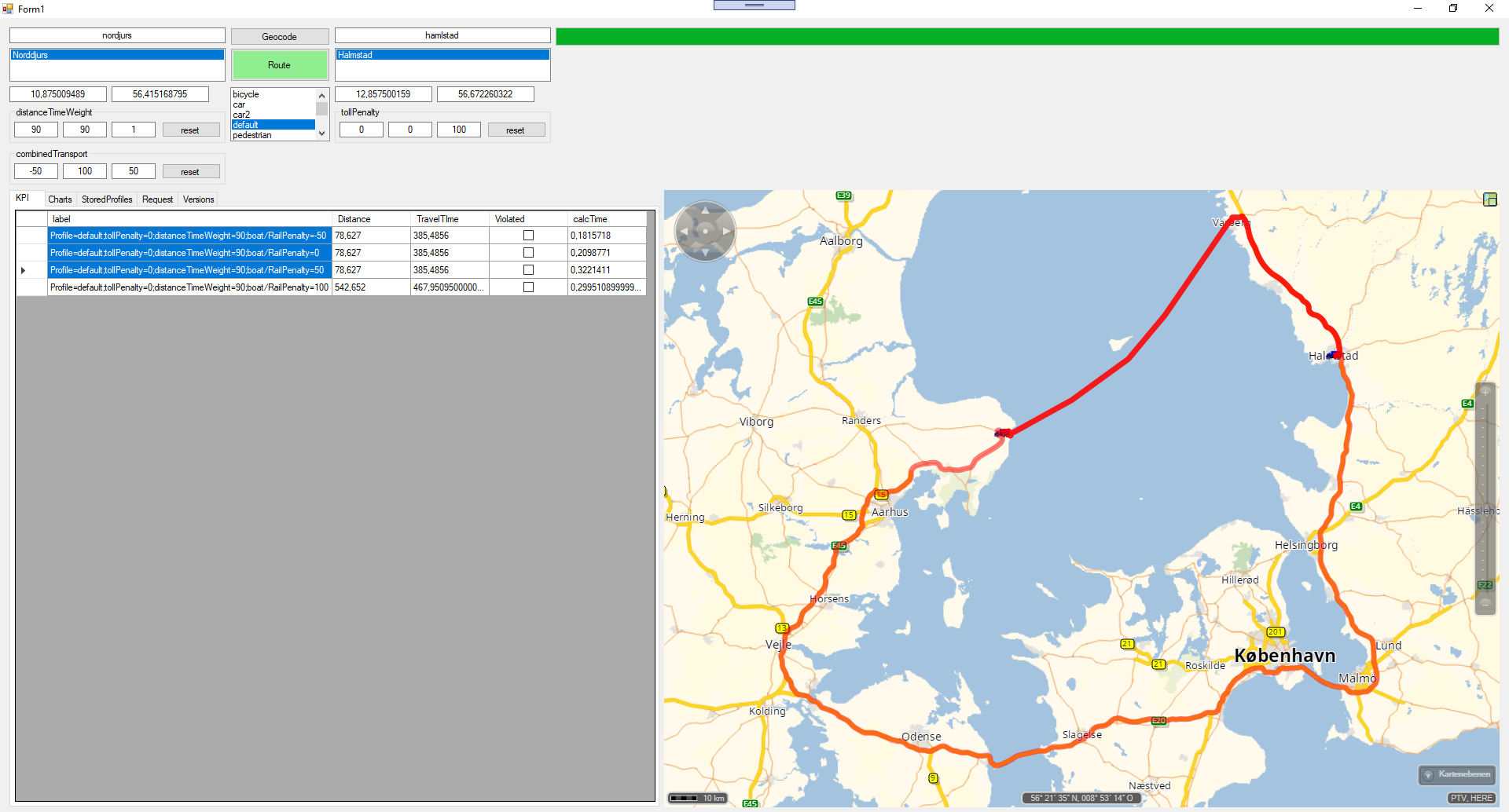

how about the CombinedTransport Parameter?
By Default it is set to 100 but you could set it to
  • 0 to define "I do not punish ferries
  • values below 0 to push ferries (if this desireable)
different values of CombinedTransport.BoatPenalty (-50 / 0 / 50 / 100)

Hello Bernd,
That looks (and works) perfectly and I somehow missed it in the documentation.
