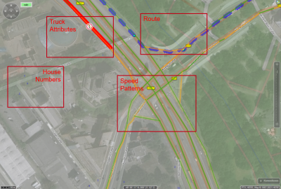

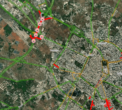

recently I've been asked whether we can provide satellite or aerial images through xMap. Yes, PTV can sell access to HERE satellite images which are then available as an additional layer within your mapping framework. The xMap server doesn't use the images by himself but by creating a mesh up built of HERE satellite images and one or more PTV xMap layers you can create a user interface that looks like this one:
Update 26.7.2022: we also offer Satellite images through our new PTV Developer APIs!
Fancy: you can add the PTV layers on top of the satellite images created by HERE. It is also possible to use transparency between the layers - isn't that cool?
If you want to check the HERE Satellite Images API check this page. For the access to this additional HERE layer PTV can resell a HERE token. If you want to get more details about this get in touch with your sales counterpart or your technical consultant.

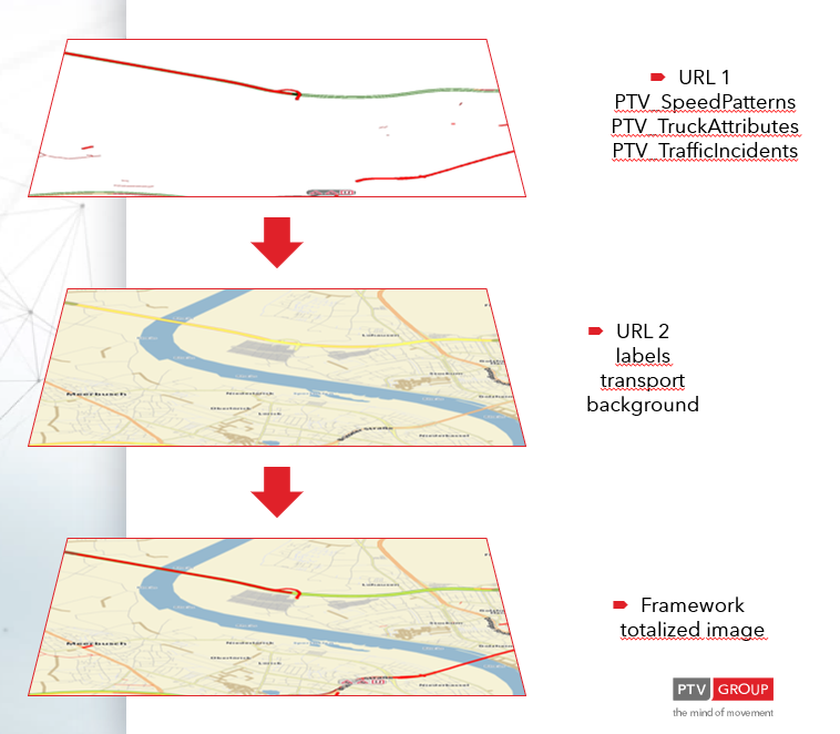

Mashup of two URLs<br />1st layer : image with SpeedPatterns, TruckAttributes, TrafficIncidents.<br />These layers are merged on the server side<br /><br />2nd layer : image with base layers transport, background ans labels (also merged in the server)<br />3rd pic: superpositioned image, layers are mashed up on client side <br />through the mapping framework such as Leaflet, OpenLayers, xServer.NET...
Mashup of two URLs
