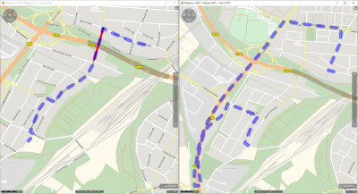

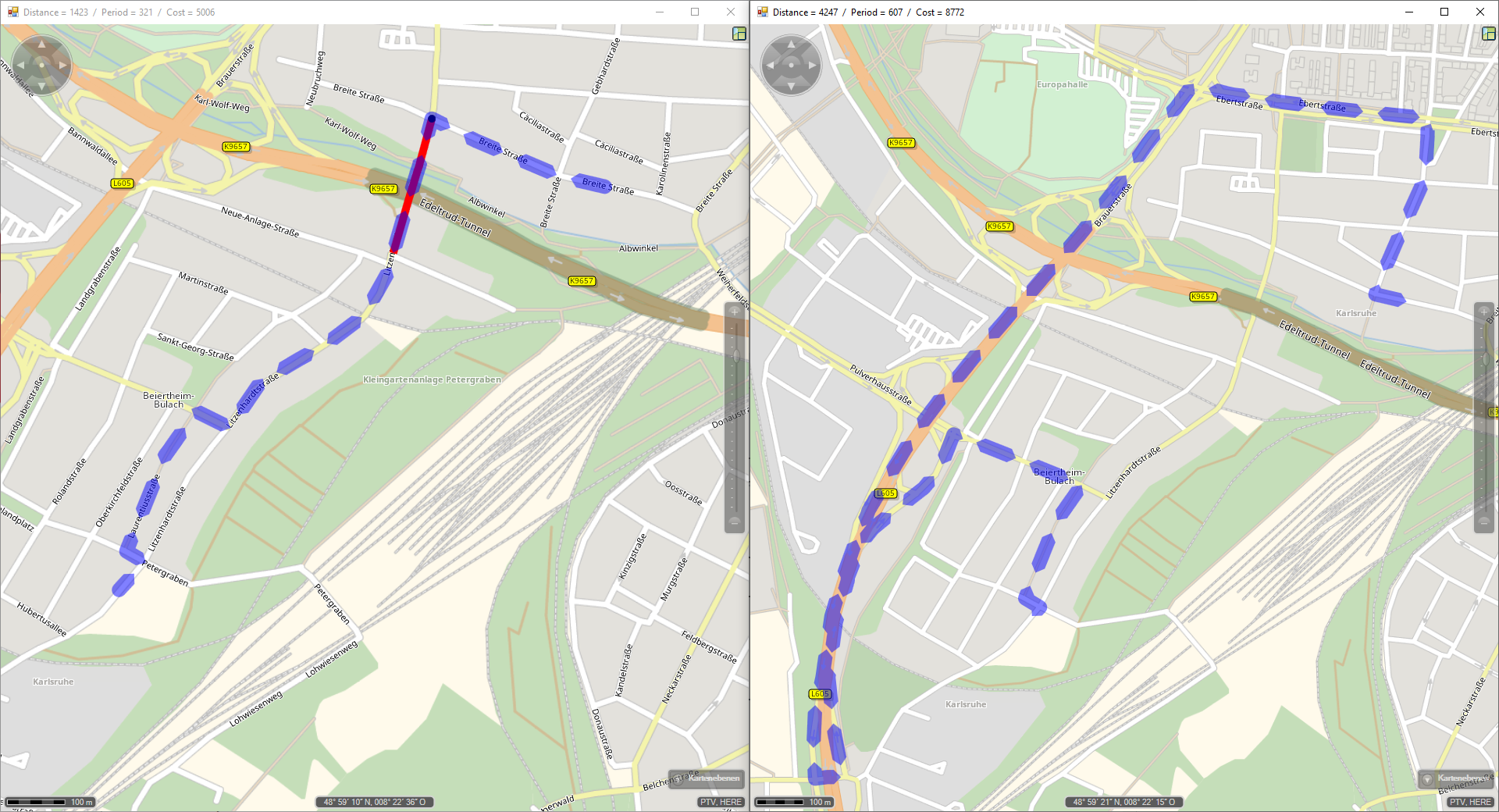

left: no attributes activates. The route follows a path under a bridge with a 2.60m height restriction.<br />right: the vehicle's height is set to more than 2.6m and the additional content is content is activated. This leads to the necessary detour.
