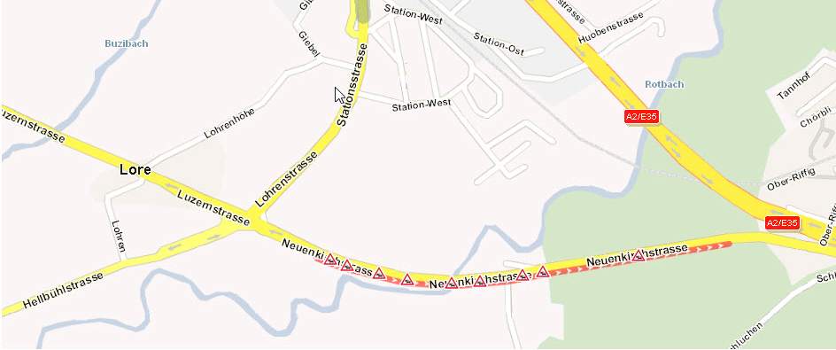

We are displaying Traffic updates with PTV_TrafficIncidents layer in xMap.
And on our PTV xServer Content Update Service is configured to update traffic data every 15 minutes.
In our map traffic jam is displayed:

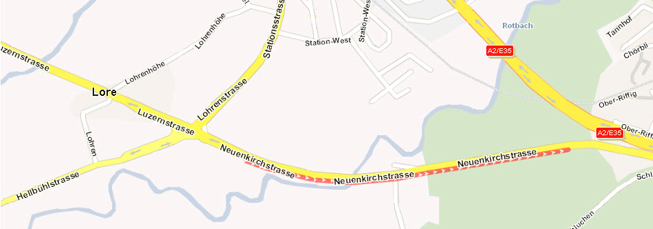

After some time when traffic jam clears away map is displayed:
So as you can see, the traffic jam symbols are gone when traffic jam clears up, however red marker is till show in the Map. And this traffic jam marker does not go way from Map. After the Map is closed and opened again then clear map is displayed.
So questions are:
1) Why the traffic jam red marker not going away on it's own. Do we have to do some kind of refresh to remove it?
2) Does the Ptv.XServer.Controls.Map.Map class refresh traffic data automatically or do we have to implement refresh logic on our own?
