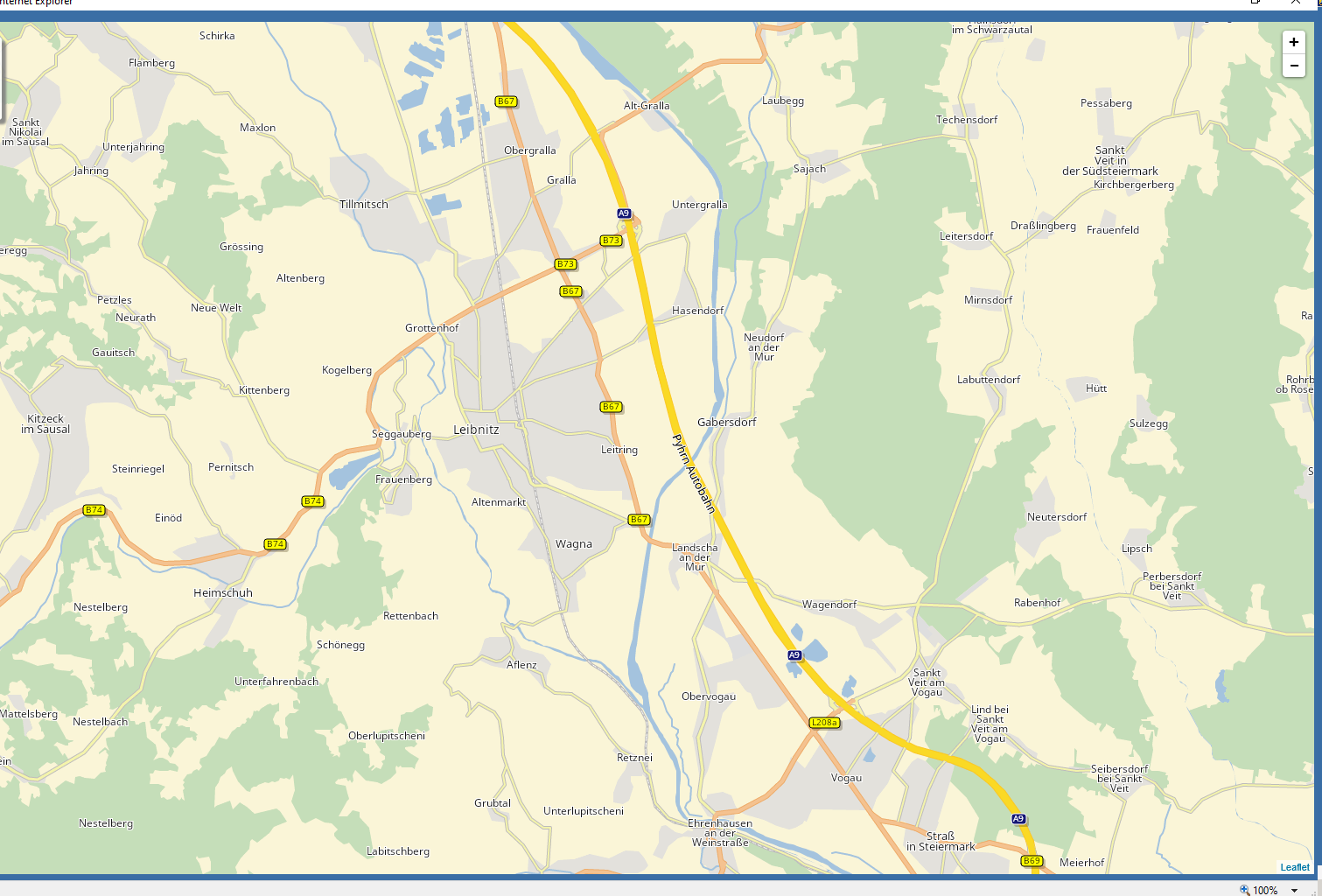

On my Laptop it works fine and quick but on a server from our customers the map doesn't load correctly.
Laptop IE:

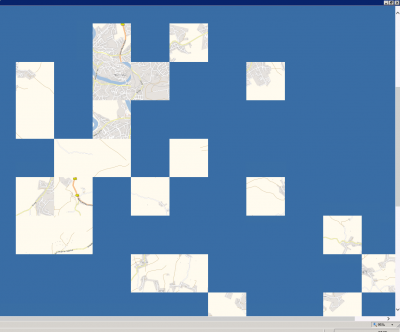

The map does not load completely
- Posts: 3056
Re: The map does not load completely
Hello Martin,
I see two errors in the attached screenshot:
- Missing tiles
- Not matching tile borders
