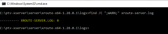

What I did was easier:
- stop the service
- remove the /featurelayer folder from the map (back them up!)
- start the service
Worked fine on my local environment:
PS: I do not expect that we create a minor 1.28 just because of this suboptimal behaviour
