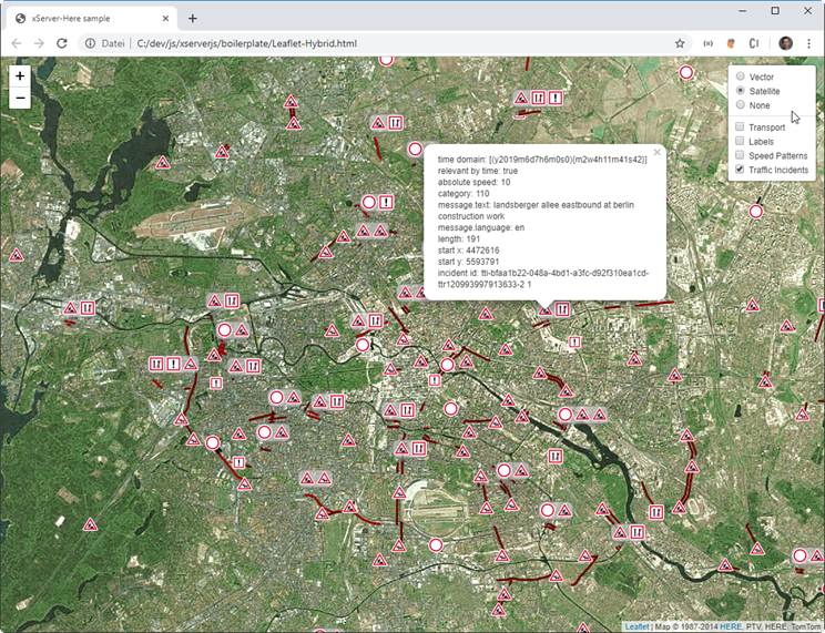

HERE Satellite images mashed up with PTV_TrafficIncidents

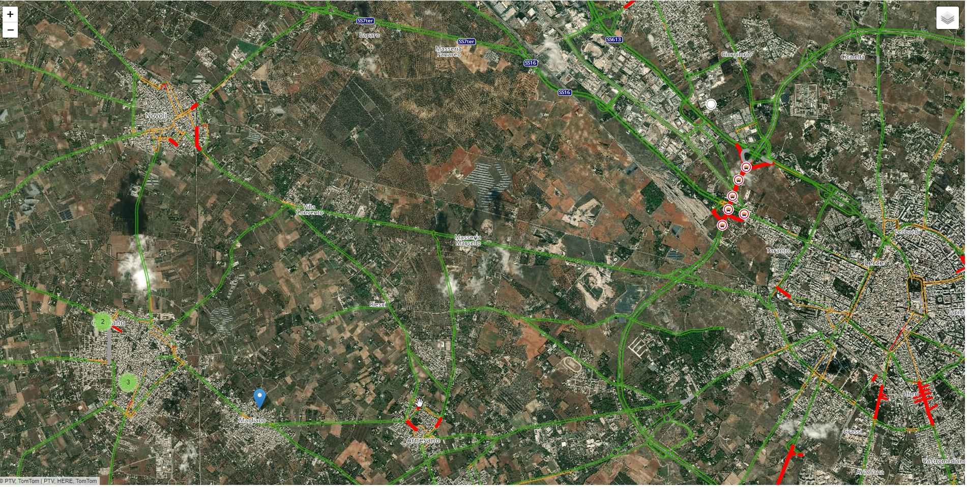

could you add the code of the xmap2 + here satellite map example?
Kind Regards,
Daniele

Posts: 3091
Re: xMap2: how to retrieve specific layers only? (REST)
Hello Daniele,
there's not a single call for what you need. It requires a mesh up of the
- here call to gather the satellite image
- the call to xmap2 to gather the feature layers
You then have to create the superposition of two layers with the technique that is provided by the framework you use. Which one do you need? I'd like to get one to provide it here in the forum?
We could also start some collection...
Best regards to my Italian friends!
danper
Posts: 19
Joined: Mon Apr 28, 2014 8:16 am
Post by danper »
we are using leaflet JS on a webpage. In the meanwhile, we solved using adding an extra tile layer for the satellite HERE maps...
Kind Regards
Daniele e Fabio
