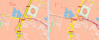

  • Both maps are created on the same server with the same map version (2019.2H)<br />LEFT: Road Editor / TruckAttributes<br />RIGHT: FeatureLayer PTV_TruckAttributes<br />Some attributes seem missing in the left map
