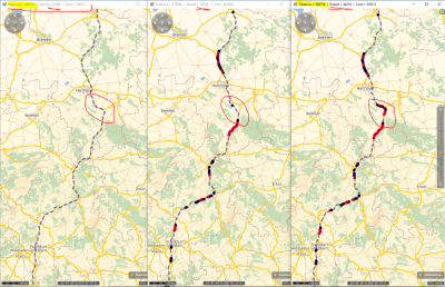

left: standard route, determined without TrafficIncidents (569km / 6h35m)<br />Middle: dynamic route performing a detour around the traffic South of Hannover (570km / 8h30m) <br />Right: standard route geometry with dynamic time: longer driving period due to jam (569km / 12h15m)<br /><br />So the path of the left and the right route are equal but the driving times differ.
