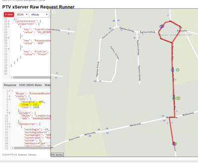

I have a problem with xRoute's calculateRoute function: Having three waypoints the calculated route makes a long detour instead of using a roundabout for a much shorter route (on the attached image I have marked the expected route in green).
Any help/pointers would be appreciated.

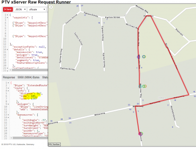

I reproduced the scenario on the following service URL:
https://api-test.cloud.ptvgroup.com/pag ... quest.html
shorter distance (496m) but longer period (112sec)
longer distance (512m), but shorter period (105sec)
So by optimizing "by period" you get the track without the roundabout...
Any further questions?

thanks for your reply, but it does not quite capture my problem.
In your case the difference between the two routes is only 7 seconds / 16 meters and depending on distance or time one or the other route is better.
However in my case, as displayed on the screenshot in my original post, the computed route is much worse in time as well as distance.
Computed Route (red): distance: 2869, time: 398
Expected Route (green): distance: ~568, time: ~86
I'm using the PTV xServer Raw Request Runner on a local server (JSON, xRoute, calculateRoute).
Best regards, Tobias
