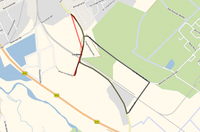

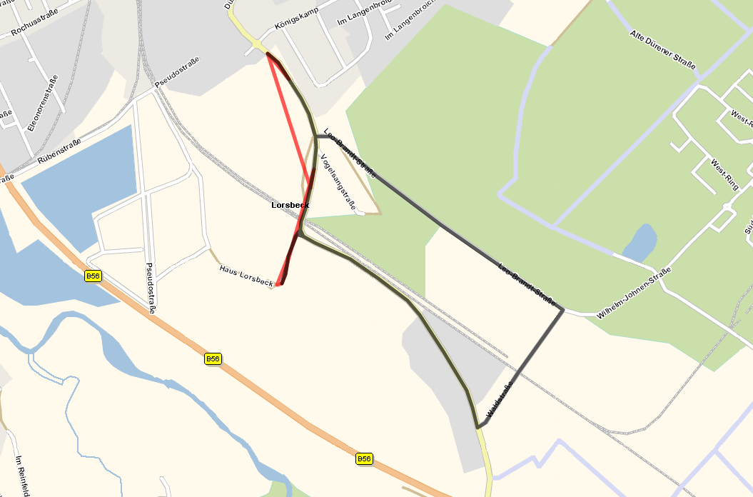

probably you can help me with our current use case:
We want to display the actual driven road on a map with help of xMapMatch and get distance and toll of this exactly route.
For this we currently do the following steps:

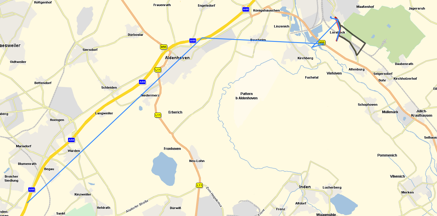

  • - a third party software sends us a GPS track (coordinate array) (result --> see the blue track in the screenshot)
    - I am mapping this to the xMapMatch request structure to call the webservice method matchTrackExtended (result --> see the red track in the screenshot)
    - After this I am taking the xMapMatch response to call calculateExtendedRoute to receive toll and distance for this track.
Since I am recalculating the route with the webservice call (calculateExtendedRoute), the result differs a lot to the input track.
Therefore, my question:
Is it possible to calculate distance and toll with an exact input route (xMapMatch result)? I would need to avoid a recalculation to have exact results.
Many thanks!
If you have any further questions do not hesitate to ask me.
Julian Ulonska

General note: when looking at your input signal getting a good match will be difficult. The points are far away and there are a few points with a relative high drift. if you only get coordinates from your provider this will be an issue. If you receive more information like heading or data quality then it becomes easier to solve.
