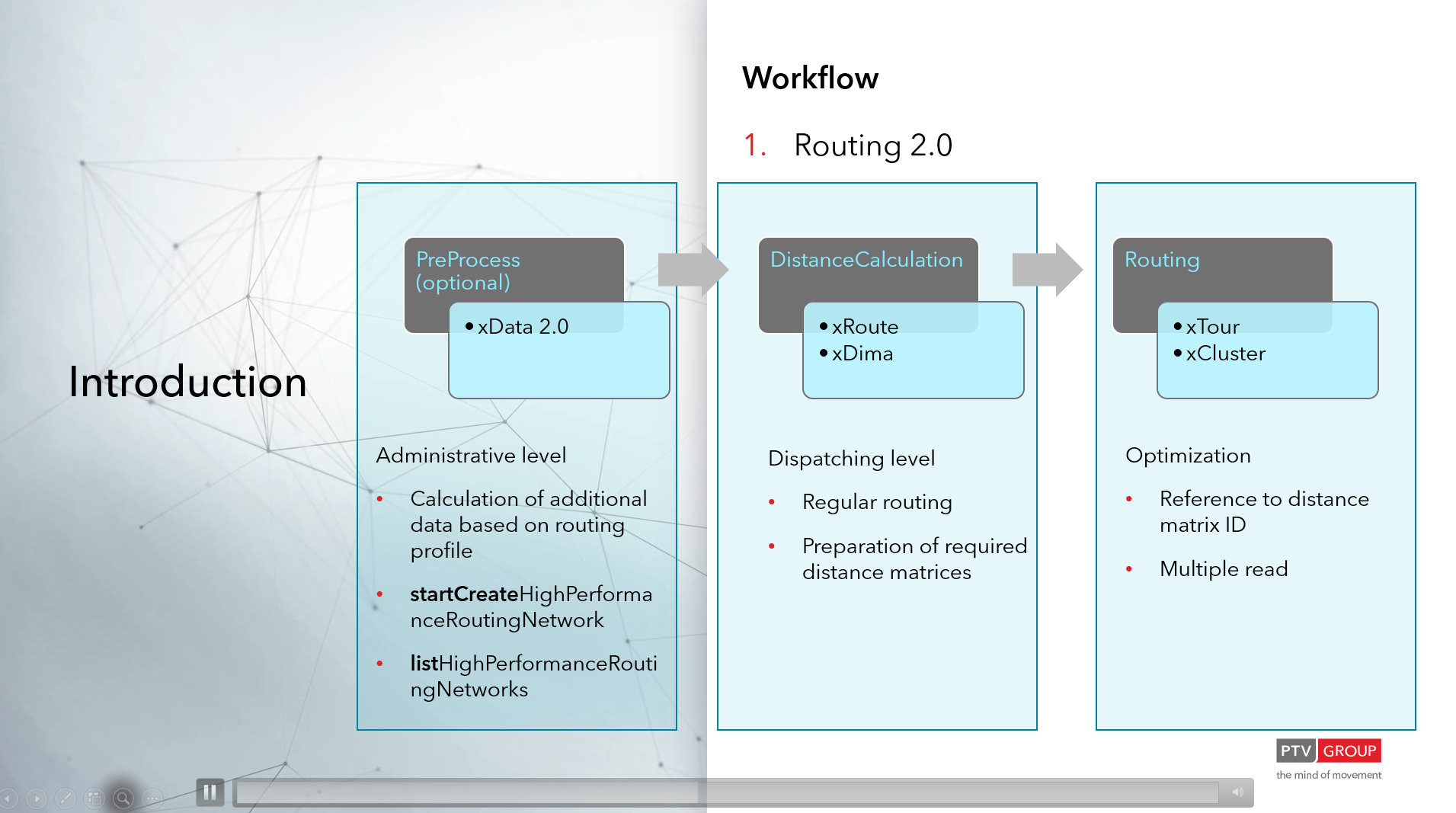

The second question "how to activate routing in xTour 2 optimization?" is a different topic: for a proper answer I need the request you use. On a theoretical base I assume the following conditions to be considered:
- The request profile isn't relevant
- Before you can use a road based distance matrix in xTour (or xCluster...) to determine driving times and distances you need to create the distance matrix via xDima. This call will provide a distance matrix ID
- in the tour optimization call with xTour you refer to this dima ID
Process of<br />1. searchgraph calculaltion<br />2. dima creation<br />3. optimization<br />Requires 3 APIs in xServer2
Process of
2. dima creation
3. optimization
If I am right then your optimization call is based on no distance matrix ID which means "airline" is used.
PS: provide the request via email to bernd.welter@ptvgroup.com for a custom analysis (via a ticket)
