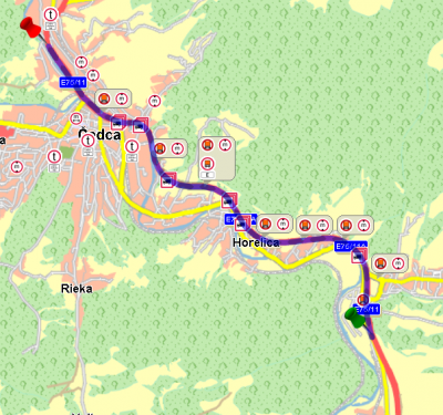

I have a problem. I use Vehicle => Load => hazardousGoodsType. When I use HAZARDOUS options everything works ok, but when I use HAZARDOUS_TO_WATERS, COMBUSTIBLES or COMBUSTIBLES_HAZARDOUS_TO_WATERS the route goes through areas where "are not allowed for vehicles carrying hazardous goods". Why does it work that way?

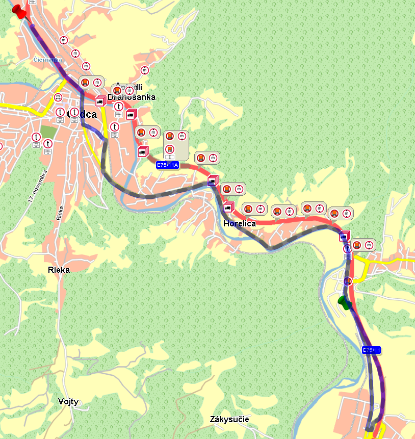

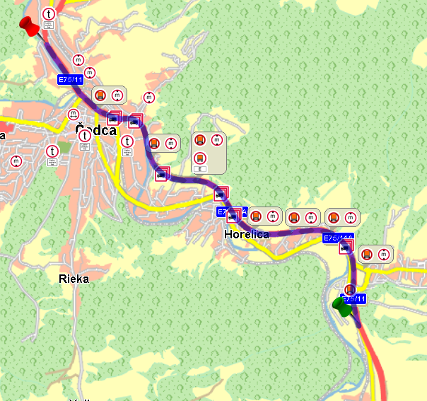

But in both case I do not use tunnel Restriction Code. I am asking why I have different results for HAZARDOUS and for example HAZARDOUS_TO_WATERS. Why for HAZARDOUS the route do not goes through areas where "are not allowed for vehicles carrying hazardous goods" and for HAZARDOUS_TO_WATERS goes.

I attached a sample request and a picture for both case.

thanks for the files (sent 1:1). I analysed them. Looks like our topic is the combustibles call (Snippet line 11 and 43):

In line 11 you define the load as "COMBUSTIBLE". Though I'd expect that "COMBUSTIBLE" is a special case of "HAZARDOUS" and therefore should be included it isn't treated like that.
From my perspective the ENUM based approach is an issue:
  • It does not offer each possible combination
  • Even the available ones aren't handeled properly
I'll check this with DEV (was already in touch with one of the experts) and get back with a description.
