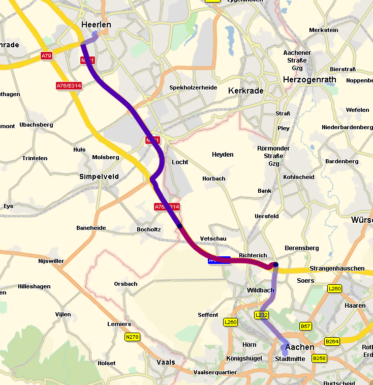

    Sample route from Aachen (GER) to Heerlen (NDL). The purple part is VIGNETTE in Netherlands. The red part is TOLL in Germany. The route itself is a bit longer.

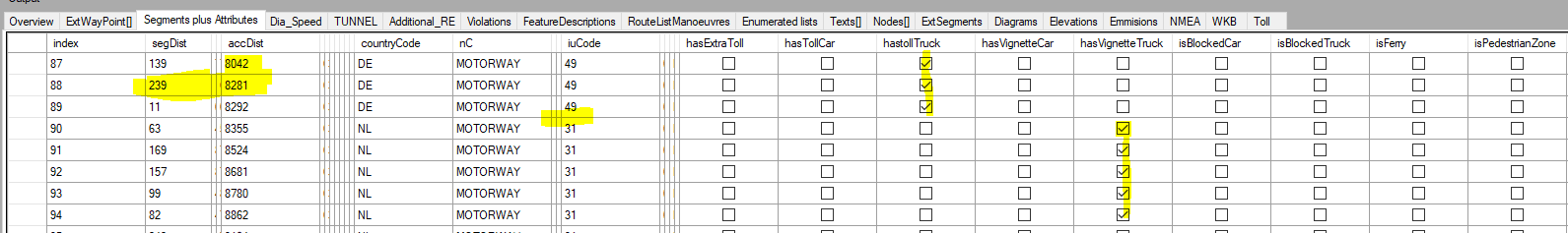

    For vignette it is different: you have to aggregate relevant contributions of xroute1 route response yourself: we let you know what segments require a vignette (check the SegmentAttributes) and the length of the segments (check the aggregated distances ;-) ). So you can easily aggregate the "vignette distance per country" or the "vignette distance at all" (just doesn't make sense most times :twisted: )
    :cry: Unfortunately xroute2 does not return vignette info (as of 1.10.2023 / v2.30)
    Segment length is derived by succeeding accDistance. While the German segment are TOLL relevant the Dutch ones are VIGNETTE relevant.
