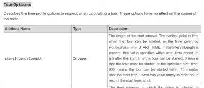

Check the xRoute1.TourOptions

I already setted the START_TIME routingparameter, but I commented it out because I thought it will causing errors.
Now its working, thanks!
