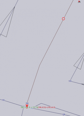

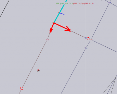

So here we go... though I can't provide a 100% solution I have new info about this (thanks to Frank for the analysis):
The area we are refering to seems to be restricted by so-called gates.
Let's start with some screenshots from an internal tool:
entering from the north doesn't work because there are turning restrictions which prevent us from getting into the delivery area.
Entering from the south is also impossible due to the same turning restrictions.

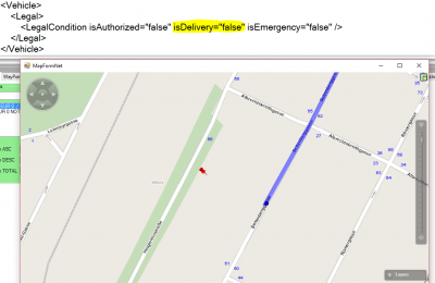

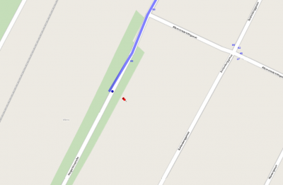

If you set the deliveryFlag to false the linking favours a segment which can be reched without such problems:
(Linking successful to the segment in the east - further away but easier to reach)
Does this help?

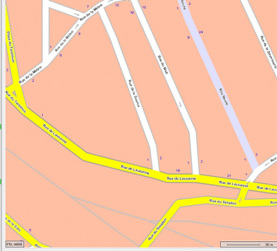

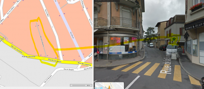

Hello Pedro,
looks like the road is forbidden in the TOMTOM data:
Left: map data TOMTOM : segment &quot;rue de la source&quot; looks like a pedestrian road. Not applicable for &quot;ordinary&quot; cars.
Left: map data TOMTOM : segment "rue de la source" looks like a pedestrian road. Not applicable for "ordinary" cars.
In the HERE map it is a regular road.
HERE map
HERE map
Maybe you can provide your exact XML request so we can reproduce and "tune" it?
