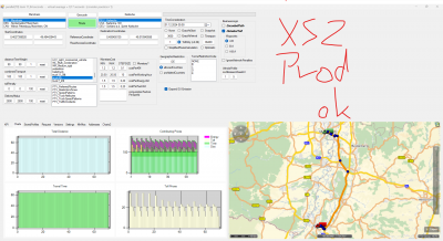

Re: New toll tarrifs for Germany (dec2023 / july2024)
Posted: Tue Oct 24, 2023 10:57 am

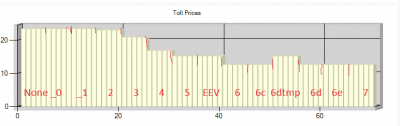

Here's a sample computed on
XServer2 Internet PROD:
- in groups of 5 "CO2Emission classes" I iterated over the different EU Emission classes (NONE, EURO_0, EURO_1, ...)
WIthin a given
com.ptvgroup.xserver.vehicleprofile.EmissionStandardEU the toll is equal.
Looks "strange"...
Which environment did you use?

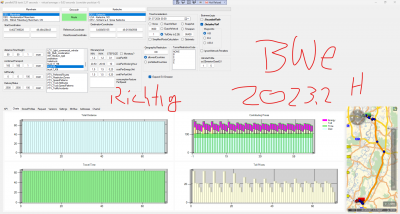

Posted: Tue Oct 24, 2023 11:36 am
- here's how it should look like... (retrieved on my local map)
We are investigating the issue's cause
Posted: Tue Oct 24, 2023 2:20 pm
Meanwhile we performed a rollback to the 2023.2H map on the european cluster (XServer2-EU) and the scenario's are ok now:
- calculated on https://xserver2-eu.cloud.ptvgroup.com/
