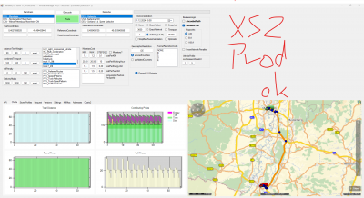

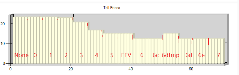

Posts: 2966
Re: New toll tarrifs for Germany (dec2023 / july2024)
Here's a sample computed on XServer2 Internet PROD:
in groups of 5 &quot;CO2Emission classes&quot; I iterated over the different EU Emission classes (NONE, EURO_0, EURO_1, ...)
in groups of 5 "CO2Emission classes" I iterated over the different EU Emission classes (NONE, EURO_0, EURO_1, ...)
WIthin a given com.ptvgroup.xserver.vehicleprofile.EmissionStandardEU the toll is equal.
Looks "strange"...
Which environment did you use?

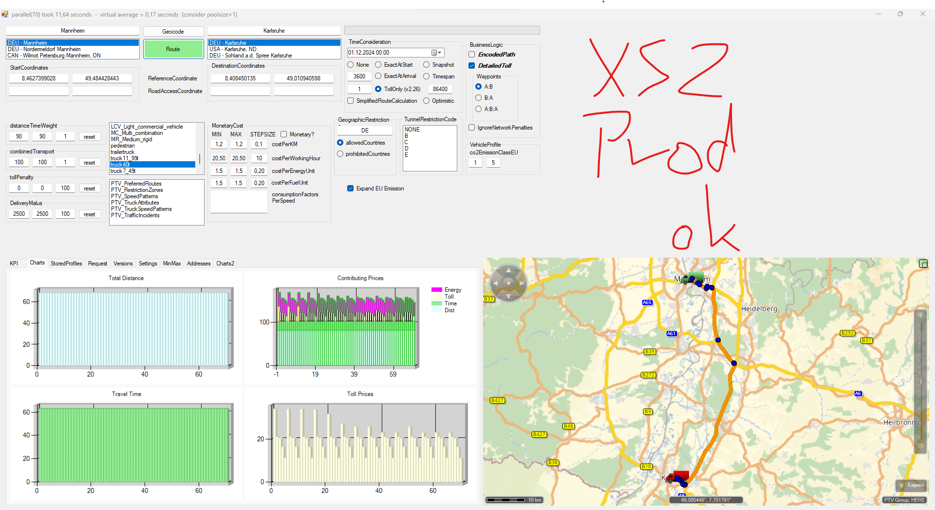

Posts: 2966
here's how it should look like... (retrieved on my local map)
We are investigating the issue's cause

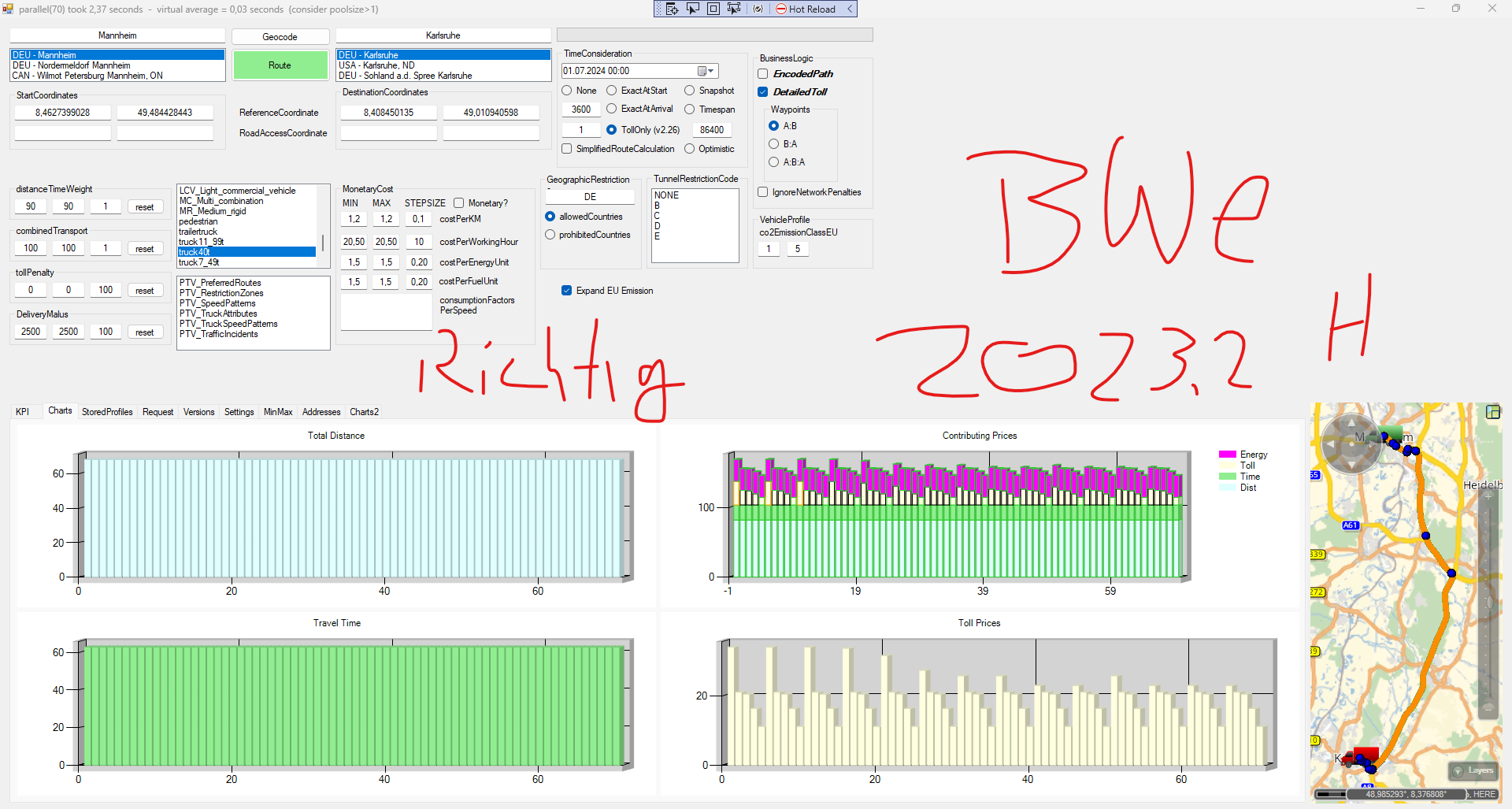

Posts: 2966
Meanwhile we performed a rollback to the 2023.2H map on the european cluster (XServer2-EU) and the scenario's are ok now:
calculated on https://xserver2-eu.cloud.ptvgroup.com/

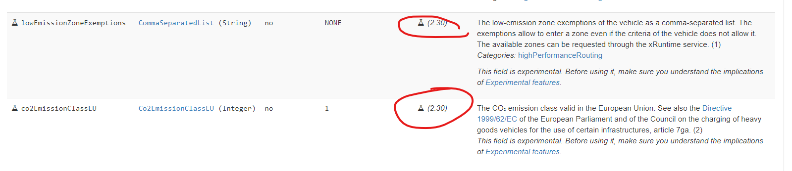

I calculated some routes in december with xServer Internet and the toll results look good so far.
But.. Is there any update planned before december?
The "co2EmissionClassEU" field is currently experimental.
I would like to avoid connecting the experimental API to a production system.
Thanks.
