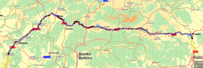

I would like to ask one question. How actual information about toll roads are in xServer.
My customer is the Slovak Republic told me that my application writes a bad toll distances. For road between Beck (17.878045,48.765518) and Prešov (21.260764, 48.950032) is a difference of nearly 100 kilometers. xServer gives toll distance 208 km, but according to the official site to calculate tolls on Slovak (https://www.emyto.sk/) is a toll distance 308 km. Both calculations allow for driving on the same roads for a truck 40 tons EURO5.
When I checked the calculated data and some of the roads xServer not identified as a toll, even though in reality they are toll roads.

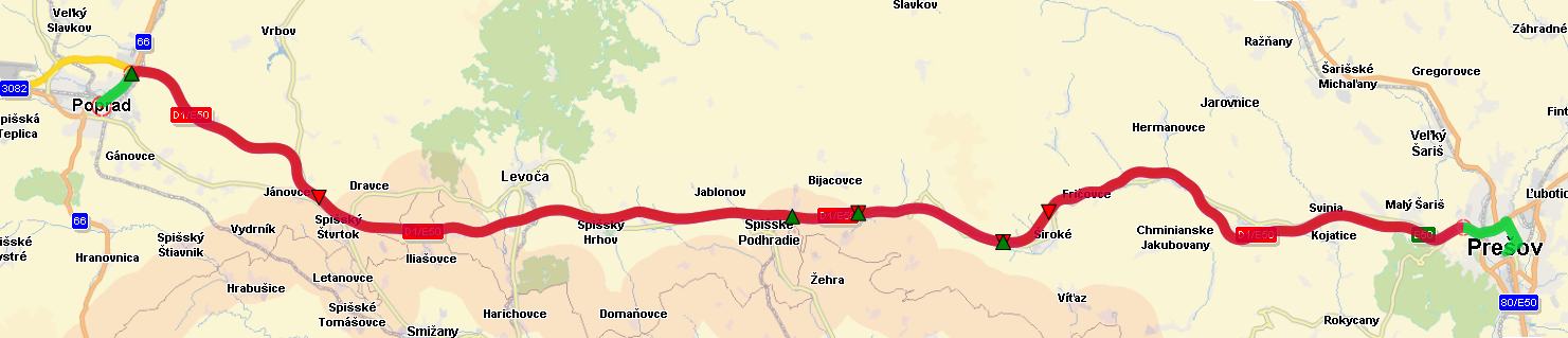

Hello Bernd,
I tried, if this problem has been fixed toll and I found that a correction toll data was performed but even so there is still a mistake.
The figure shows a section where the toll does not count in the calculation, but in reality it is a road fee.
Vladimír

Re: Toll data
Hello Vlad,
Which map do you use? My local installation seems to return TOLL for the part you mentioned.
