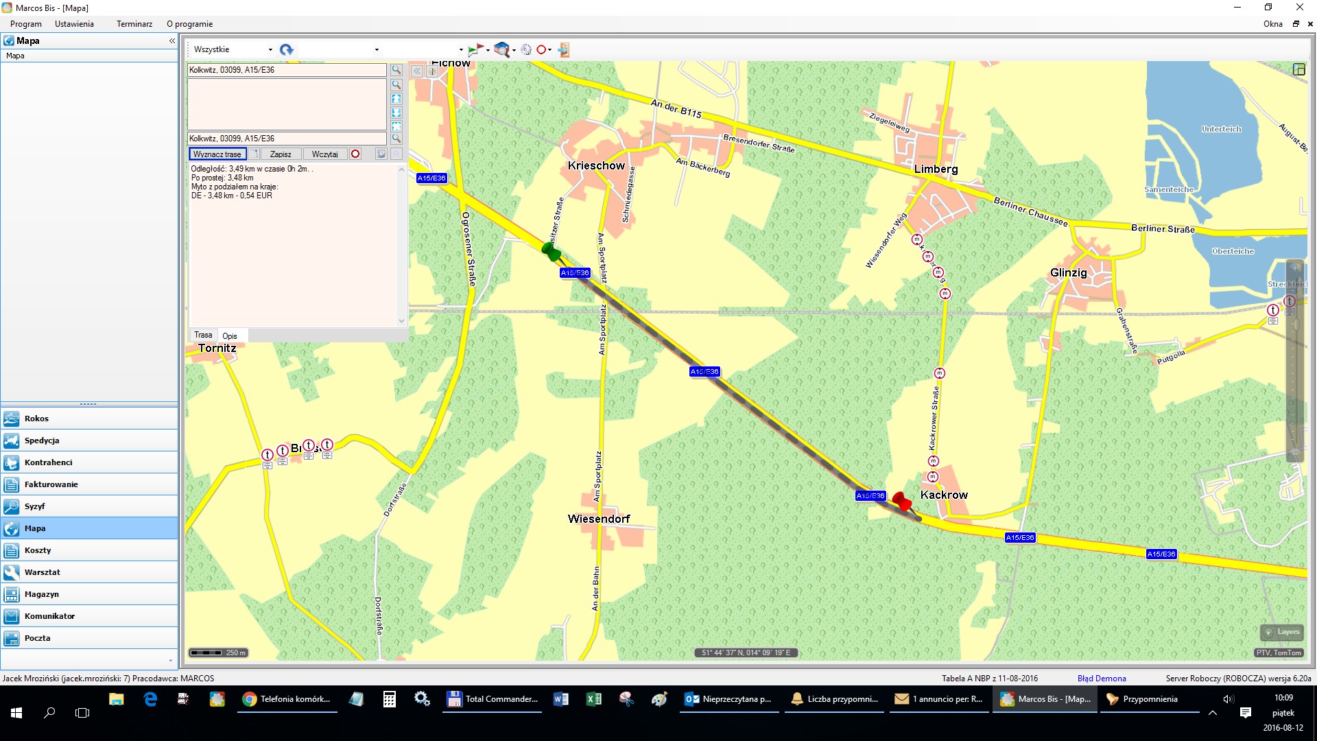

I'm testing fuzzy linking and I have one question. Consider the route near Kolkwitz

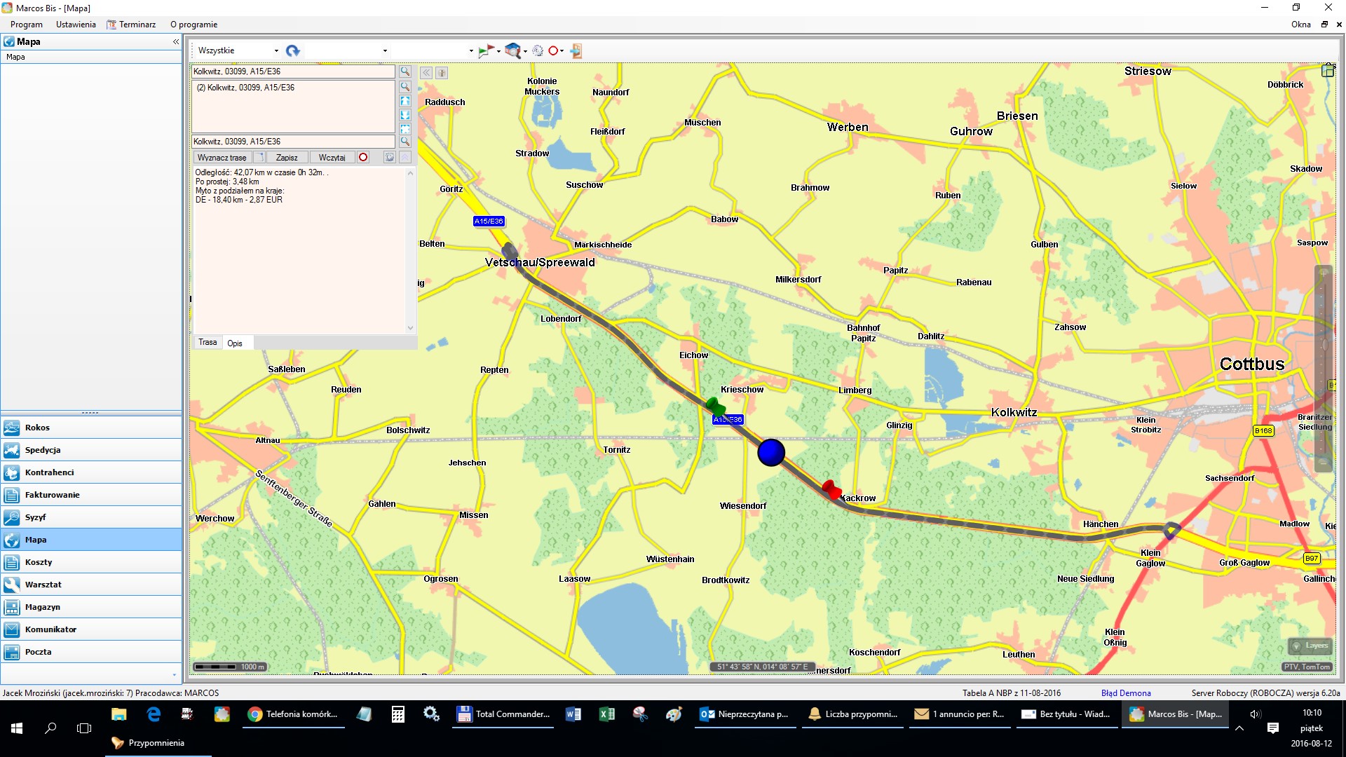

Now lets put fuzzy via point (with 2100 metres radius) in the middle of this route, and run route request again. We will se as below:
If we look a little bit closer we will see that route didn't take radius into consideration:
I thing that this route supposed to be the same with such a big radius.

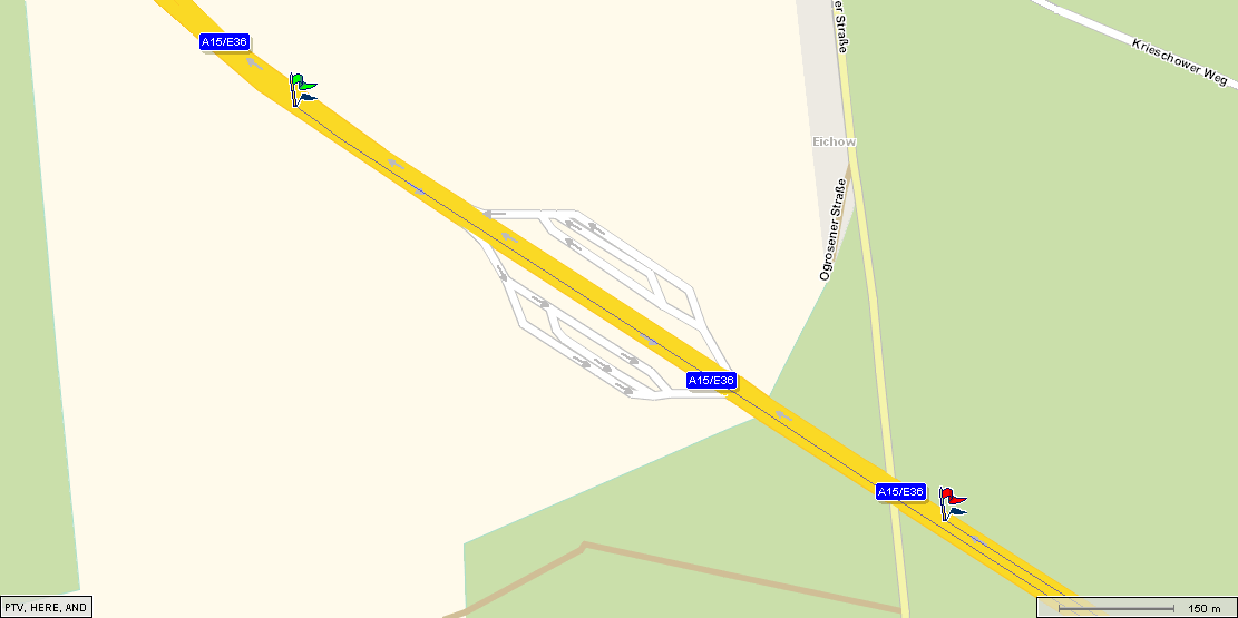

Now let's consider the exact location of BLUE: it is not located on the direct path between GREEN and RED but on the opposite driving direction. The attached screenshots show the route from [GREEN] to [BLUE]
route from GREEN to BLUE performing the nasty manoeuvre at the highway exit.

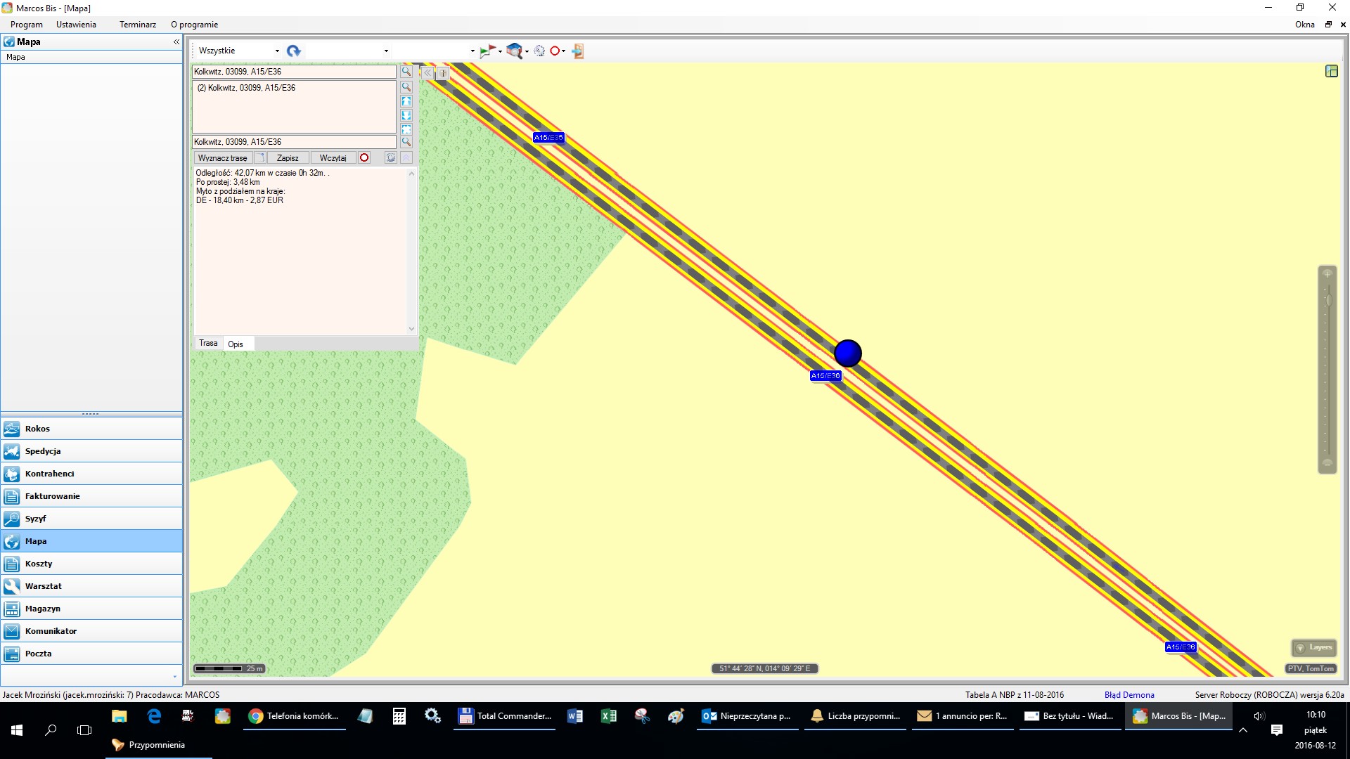

Close visualization of the route - you can see that the coordinate of BLUE is located on the wrong side.
Usually this works fine in larger areas with walking in reverse on the same highway direction. In your sample the internal logic produces such a result.
If BLUE is defined by a click in a map the probability of "choosing the proper side of the highway" is 50:50.
