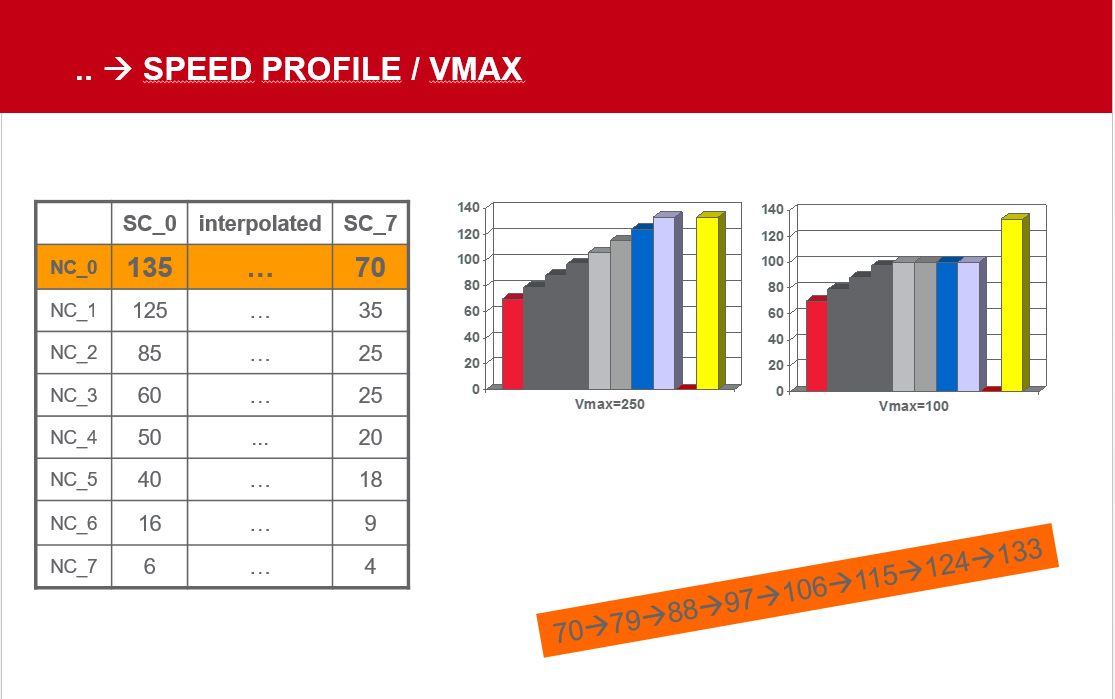

Hello guys,
@Joost: thanks for the attache image!
And for Mike: as Joost and I described there are 8 NETWORK classes that are furthermore separated into 8 SPEEDCLASSES from
This means 70km/hour on the "incredibly slow" SPEEDCLASS on NETWORK CLASS0 and 135KM/hour on the "incredibly fast" SPEEDCLASS and so on.
- incredibly fast
- fast
- bit faster than average
- bit slowlier than average
- slow
- incredibly slow
<Speed speedForAirLineDistance="36">
<SpeedRangeByNetworkClass minimumSpeed="70" maximumSpeed="135" />
<SpeedRangeByNetworkClass minimumSpeed="35" maximumSpeed="125" />
<SpeedRangeByNetworkClass minimumSpeed="25" maximumSpeed="85" />
<SpeedRangeByNetworkClass minimumSpeed="25" maximumSpeed="60" />
<SpeedRangeByNetworkClass minimumSpeed="20" maximumSpeed="50" />
<SpeedRangeByNetworkClass minimumSpeed="18" maximumSpeed="40" />
<SpeedRangeByNetworkClass minimumSpeed="9" maximumSpeed="16" />
<SpeedRangeByNetworkClass minimumSpeed="4" maximumSpeed="6" />
</Speed>
