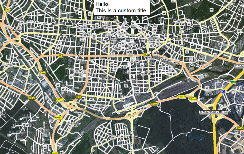

You can overlay these two images by first inserting the HERE tiles and then a semi-opaque xMapServer layer:
// HERE satellite images
sharpMap.Layers.Add(new Layers.TileLayer(new TileSource(new WebTileProvider(new HereSatelliteRequest()
{ AppId = "<your app id>", AppCode = "<your app code>" }, new NullCache()),
new SphericalMercatorInvertedWorldSchema()), "HERE"));
// xmap-bg
sharpMap.Layers.Add(new XMapLayer("xmap-bg", "https://api-eu-test.cloud.ptvgroup.com/xmap/ws/XMap", MapMode.Background)
{ User = "xtok", Password = token, Opacity = 0.5F }); // set semi-opaque for hybrid viewBy the way: The new xMap-2 will support a true alpha-channel. This allows you to build a road-only overlay. You can apply for a preview-access for xServer-2 and then use this implementation:
