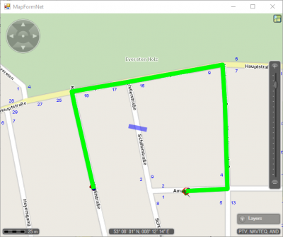

I created a quick sample:
The blue line is given as ExceptionPath and crossing the line is forbidden. This causes the router to perform a detour.
