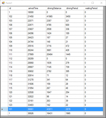

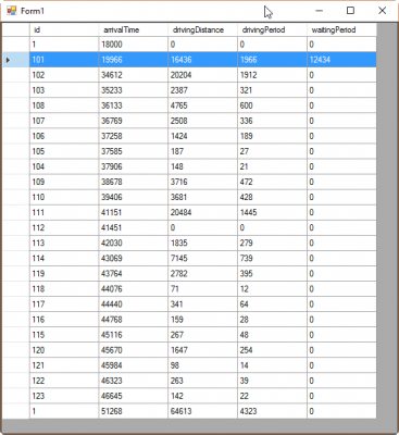

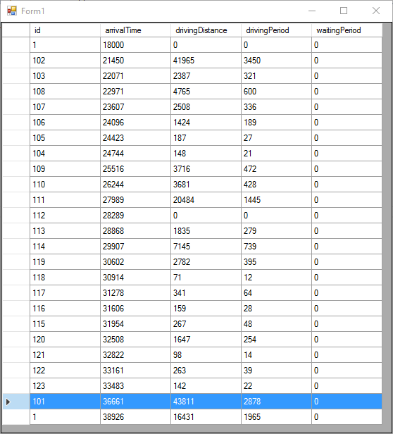

meanwhile I created a little test project via Visual Studio and I replaced the planSequence with planBasicTours. The later method is my favourite because it enables you to have a more flexible access to the planning steps and methods.
By simply activating improvement the quality of the result is as desired. I recommend to use planBasicTours though the signature of the method looks more complicated than necessary (for 1 single vehicle optimization).
Without improvement, just construction and middle sequencing. The critical 09:00-22:00 stop with the ID=101 is indeed visited as first order and produces severe waiting period due to the fixed start time.
By applying an additional improvement step the order 101 is changing his position to the end of the tour.
