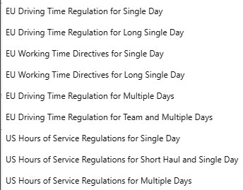

One of the most obvious and practical differences is the configurableWorkingHoursPreset field available in xTour2 and xRoute2:
I reviewed the Optiflow break settings concept and I understand that the idea is to provide a more generic and expressive way to define regulations. However, I think it would still be very useful if commonly used regulations could also be provided directly by PTV, similar to how it worked in xServer.
Otherwise, each API consumer has to implement and maintain the same regulation logic on their own.
So my question is:
  • Are there any plans to introduce a preset-based feature in Optiflow?
  • Or maybe these regulations are already defined internally according to the Optiflow data model and can somehow be reused directly (or shared separately)?

Preset Modelable? Reason
EU_DRIVING_TIME_REGULATION_FOR_SINGLE_DAY ✅ Driving + working breaks only
EU_DRIVING_TIME_REGULATION_FOR_LONG_SINGLE_DAY ✅ Same, with extended driving limit
EU_WORKING_TIME_DIRECTIVE_FOR_SINGLE_DAY ✅ Working breaks only
EU_WORKING_TIME_DIRECTIVES_FOR_LONG_SINGLE_DAY ✅ Working breaks only
US_HOURS_OF_SERVICE_REGULATIONS_FOR_SINGLE_DAY ✅ Driving break only
US_HOURS_OF_SERVICE_REGULATIONS_FOR_SHORT_HAUL_AND_SINGLE_DAY ⚠️ No breaks scheduled (short-haul exemption) — trivial
EU_DRIVING_TIME_REGULATION_FOR_MULTIPLE_DAYS ❌ Requires daily rest (11h), weekly limits
EU_DRIVING_TIME_REGULATION_FOR_TEAM_AND_MULTIPLE_DAYS ❌ Requires daily rest, team rules
US_HOURS_OF_SERVICE_REGULATIONS_FOR_MULTIPLE_DAYS ❌ Requires daily rest (10h)
