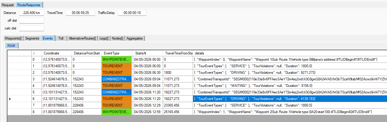

Posts: 3103
Re: #6506 : DRIVING event is not displayed after WAITING in certain scenario
Hi Marius,
I just talked to Yann / DEV. Your requests do not show the "malicious" behaviour on
  • my local v2.40
  • xServer Internet v2.40
Therefore I assume that you were running into a bug that has been fixed in the meantime.
Please download/install the latest version of xServer2 = 2.40 and test again.
If the problem still happens we need you to create a regular helpdesk ticket.
For the moment we are confident that there's no todo on our side.
response of request #4 based on v2.40 (xServer Internet)
