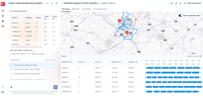

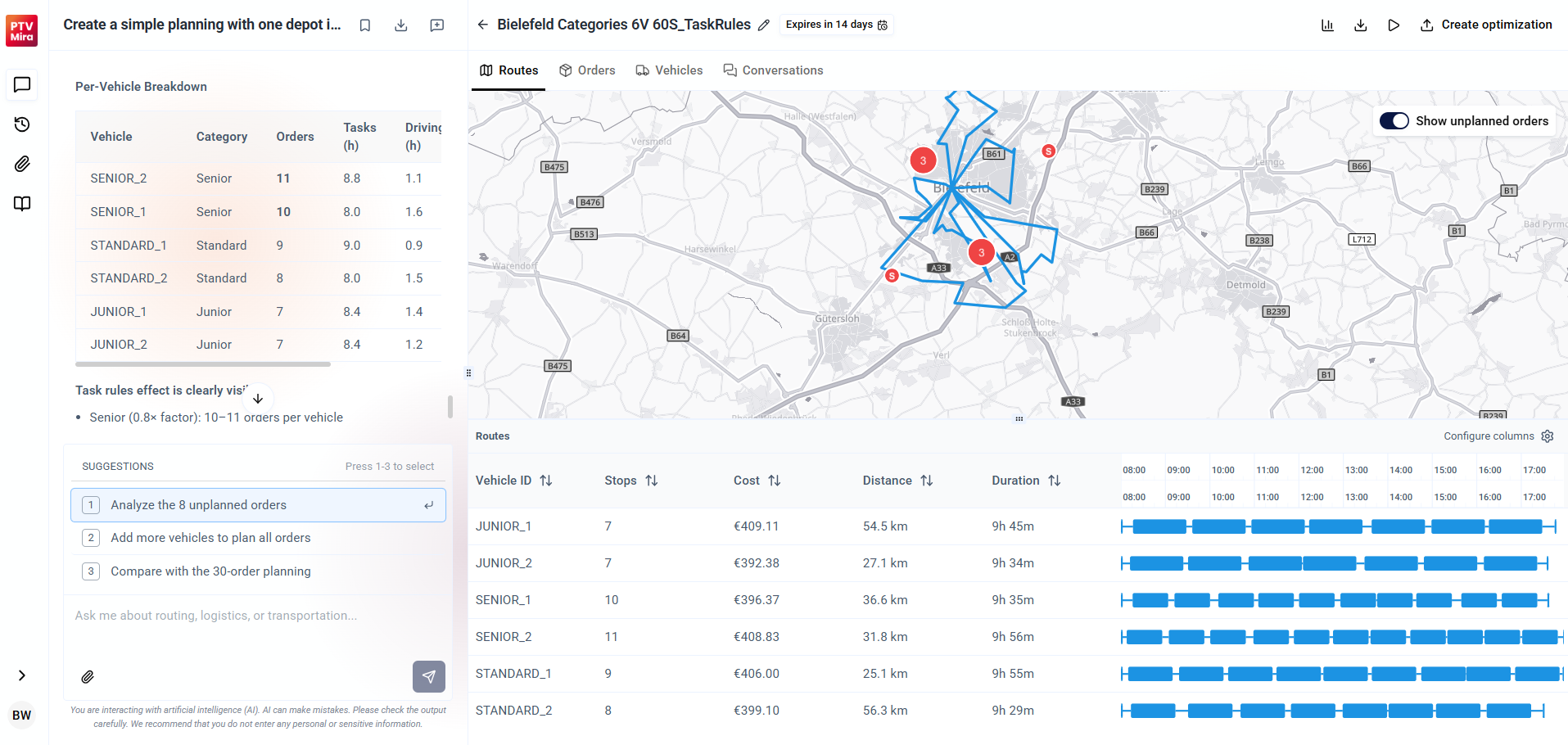

As you can see in the GANTT: though all original durations in this example are set to 60 minutes the juniors require longer, the Experts are faster and can manage to service 10/11 orders during the shift
